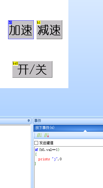

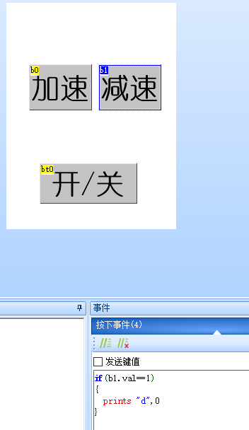

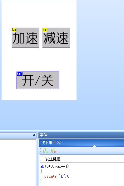

#include <reg52.h>
#include <stdio.h>
#define uint unsigned int
#define uchar unsigned char
sbit _4IN = P1^0;
sbit led1 = P1^7;
uchar a,js,pwmt,flag;
int bd;
void Init()
TMOD = 0x21;
SCON = 0x50;
TH0 = (65536-10)/256;
TL0 = (65536-10)%256;
TH1 = 0xfd;
TH0 = 0xfd;
EA = 1;
ES = 1;
ET0 = 1;
TR0 = 1;
TR1 = 1;
void Timer0() interrupt 1
js ++;
if(js == 100)
js = 0;
void Ser() interrupt 4
RI = 0;
a = SBUF;
void kg()
int i;
for(i=0;i<9999;i++)
if(a=="k")
flag = 1;
led1 = 0;
if(i == 9999)
i = 0;
void bdz()
if((a=="j")&&(flag == 1))
bd += 10;
if(bd>100)
bd = 100;
if((a=="d")&&(flag == 1))
bd += 10;
if(bd<0)
bd = 0;
void pwm()
while(pwmt<bd)
_4IN = 1;
_4IN = 0;
void main()
// _4IN = 0;
Init();
kg();
bdz();
pwm();
if(a=="g")
_4IN = 0;
led1 = 1;
