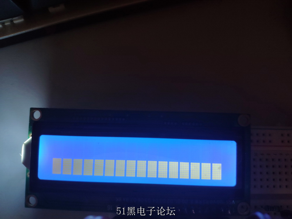

仿真可以,但是实物接的时候就不行
//函数声明
void Read_Busy(); //忙检测函数
void Lcd1602_Write_Cmd(unsigned char cmd); //写命令
void Lcd1602_Write_Data(unsigned char dat); //写数据
void LcdSetCursor(unsigned char x,unsigned char y); //坐标显示
void DisplayOneChar(unsigned char X, unsigned char Y, unsigned char DData); //显示字符
void LcdShowStr(unsigned char x,unsigned char y,unsigned char *str); //显示字符串
void InitLcd1602(); //初始化
#include"lcd.h"
void Read_Busy() //忙检测函数,判断bit7是0,允许执行;1禁止
unsigned char sta;
LCD1602_DB = 0xff;
LCD1602_RS = 0;
LCD1602_RW = 1;
do
LCD1602_EN = 1;
sta = LCD1602_DB;
LCD1602_EN = 0; //使能,用完就拉低,释放总线
}while(sta & 0x80);
/*void delay(uint n)
uint x,y;
for(x=n;x>0;x--)
for(y=110;y>0;y--);
void Lcd1602_Write_Cmd(unsigned char cmd) //写命令
Read_Busy();
LCD1602_RS = 0;
LCD1602_RW = 0;
LCD1602_DB = cmd;
LCD1602_EN = 1;
delay(5);
LCD1602_EN = 0;
void Lcd1602_Write_Data(unsigned char dat) //写数据
Read_Busy();
LCD1602_RS = 1;
LCD1602_RW = 0;
LCD1602_DB = dat;
LCD1602_EN = 1;
delay(5);
LCD1602_EN = 0;
void LcdSetCursor(unsigned char x,unsigned char y) //坐标显示
unsigned char addr;
if(y == 0)
addr = 0x00 + x;
else
addr = 0x40 + x;
Lcd1602_Write_Cmd(addr|0x80);
//按指定位置显示一个字符
Y &= 0x1;
X &= 0xF; //限制X不能大于15,Y不能大于1
if (Y) X |= 0x40; //当要显示第二行时地址码+0x40;
X |= 0x80; //算出指令码
Lcd1602_Write_Cmd(X); //发命令字
Lcd1602_Write_Data(DData); //发数据
void LcdShowStr(unsigned char x,unsigned char y,unsigned char *str) //显示字符串
LcdSetCursor(x,y); //当前字符的坐标
while(*str != '\0')
Lcd1602_Write_Data(*str++);
void InitLcd1602() //1602初始化
Lcd1602_Write_Cmd(0x38); //打开,5*8,8位数据
Lcd1602_Write_Cmd(0x0c);
Lcd1602_Write_Cmd(0x06);
Lcd1602_Write_Cmd(0x01); //清屏
