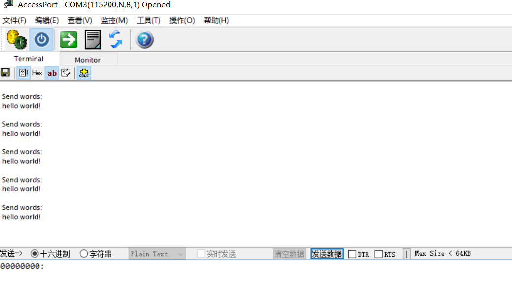

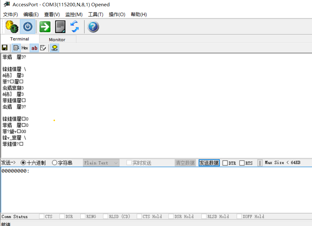

调试UWB标签串口,MCU为STM32F103,先前输出的字母为乱码,通过几天的网上学习,并完整的学习了sys_stm32f10x.c文件,在static void SetSysClockTo72(void) 修改了三处,最终串口输出正常。1.#ifdef STM32F10X_MD  //将定义STM32F10X_CL改为STM32F10X_MD
2.将RCC->CFGR2 &= (uint32_t)~(RCC_CFGR2_PREDIV2 | RCC_CFGR2_PLL2MUL | RCC_CFGR2_PREDIV1 | RCC_CFGR2_PREDIV1SRC);
    RCC->CFGR2 |= (uint32_t)(RCC_CFGR2_PREDIV2_DIV5 | RCC_CFGR2_PLL2MUL8 | CC_CFGR2_PREDIV1SRC_PLL2 | RCC_CFGR2_PREDIV1_DIV5);
修改为RCC->CFGR &= (uint32_t)~(RCC_CFGR_PLLXTPRE | RCC_CFGR_PLLSRC | RCC_CFGR_PLLMULL);
    RCC->CFGR |= (uint32_t)(RCC_CFGR_PLLXTPRE_HSE_Div2  | RCC_CFGR_PLLSRC_HSI_Div2 | RCC_CFGR_PLLMULL9 );
3. RCC->CFGR &= (uint32_t)((uint32_t)~(RCC_CFGR_PLLSRC | RCC_CFGR_PLLXTPRE | RCC_CFGR_PLLMULL));
    RCC->CFGR |= (uint32_t)(RCC_CFGR_PLLSRC_HSE | RCC_CFGR_PLLMULL9);

有时候波特率没有设对导致错误
