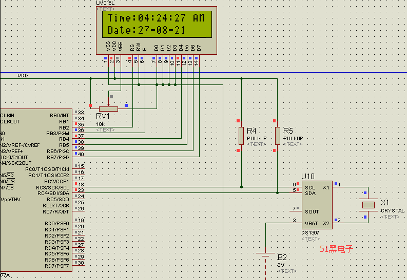

PIC16F877A单片机+DS1307实时时钟RTC程序与Proteus仿真图
  1. // LCD module connections
  2. sbit LCD_RS at RB2_bit;
  3. sbit LCD_EN at RB3_bit;
  4. sbit LCD_D4 at RB4_bit;
  5. sbit LCD_D5 at RB5_bit;
  6. sbit LCD_D6 at RB6_bit;
  7. sbit LCD_D7 at RB7_bit;
  8. sbit LCD_RS_Direction at TRISB2_bit;
  9. sbit LCD_EN_Direction at TRISB3_bit;
  10. sbit LCD_D4_Direction at TRISB4_bit;
  11. sbit LCD_D5_Direction at TRISB5_bit;
  12. sbit LCD_D6_Direction at TRISB6_bit;
  13. sbit LCD_D7_Direction at TRISB7_bit;
  14. // End LCD module connections

  79. char time[] = "00:00:00 PM";
  80. char date[] = "00-00-00";
  81. void main()
  82. {
  83.    I2C1_Init(100000); //DS1307 I2C is running at 100KHz
  84.    CMCON = 0x07;   // To turn off comparators
  85.    ADCON1 = 0x06;  // To turn off analog to digital converters
  86.    TRISA = 0x07;
  87.    PORTA = 0x00;
  88.    Lcd_Init();                        // Initialize LCD
  89.    Lcd_Cmd(_LCD_CLEAR);               // Clear display
  90.    Lcd_Cmd(_LCD_CURSOR_OFF);          // Cursor off
