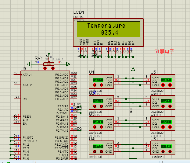

- //头文件包含
- #include <AT89X51.H>
- #include <Intrins.h>
- #include "DS18B20.H"
- //引脚定义
- sbit DQ = P2^7; //数据线端口
- //DS18B20序列号,通过调用GetROMSequence()函数在P1口读出(读8次)
- const unsigned char code ROMData1[8] = {0x28, 0x33, 0xC5, 0xB8, 0x00, 0x00, 0x00, 0xD7}; //U1
- const unsigned char code ROMData2[8] = {0x28, 0x30, 0xC5, 0xB8, 0x00, 0x00, 0x00, 0x8E}; //U2
- const unsigned char code ROMData3[8] = {0x28, 0x31, 0xC5, 0xB8, 0x00, 0x00, 0x00, 0xB9}; //U3
- const unsigned char code ROMData4[8] = {0x28, 0x32, 0xC5, 0xB8, 0x00, 0x00, 0x00, 0xE0}; //U4
- const unsigned char code ROMData5[8] = {0x28, 0x34, 0xC5, 0xB8, 0x00, 0x00, 0x00, 0x52}; //U5
- const unsigned char code ROMData6[8] = {0x28, 0x35, 0xC5, 0xB8, 0x00, 0x00, 0x00, 0x65}; //U6
- const unsigned char code ROMData7[8] = {0x28, 0x36, 0xC5, 0xB8, 0x00, 0x00, 0x00, 0x3C}; //U7
- const unsigned char code ROMData8[8] = {0x28, 0x37, 0xC5, 0xB8, 0x00, 0x00, 0x00, 0x0B}; //U8
- //延时16us子函数
- void Delay16us()
- unsigned char a;
- for (a = 0; a < 4; a++);
- //延时60us子函数
- void Delay60us()
- unsigned char a;
- for (a = 0; a < 18; a++);
- //延时480us子函数
- void Delay480us()
- unsigned char a;
- for (a = 0; a < 158; a++);
- //延时240us子函数
- void Delay240us()
- unsigned char a;
- for (a = 0; a < 78; a++);
- //延时500ms子函数
- void Delay500ms()
- unsigned char a, b, c;
- for (a = 0; a < 250; a++)
- for (b = 0; b < 3; b++)
- for (c = 0; c < 220; c++);
- //芯片初始化
- void Initialization()
- while(1)
- DQ = 0;
- Delay480us(); //延时480us
- DQ = 1;
- Delay60us(); //延时60us
- if(!DQ) //收到ds18b20的应答信号
- DQ = 1;
- Delay240us(); //延时240us
- break;
- //写一个字节(从低位开始写)
- void WriteByte(unsigned char btData)
- unsigned char i, btBuffer;
- for (i = 0; i < 8; i++)
- btBuffer = btData >> i;
- if (btBuffer & 1)
- DQ = 0;
- _nop_();
- _nop_();
- DQ = 1;
- Delay60us();
- else
- DQ = 0;
- Delay60us();
- DQ = 1;
- //读一个字节(从低位开始读)
- unsigned char ReadByte()
- unsigned char i, btDest;
- btDest >>= 1;
- DQ = 0;
- _nop_();
- _nop_();
- DQ = 1;
- Delay16us();
- if (DQ) btDest |= 0x80;
- Delay60us();
- return btDest;
- //序列号匹配
- void MatchROM(const unsigned char *pMatchData)
- unsigned char i;
- Initialization();
- WriteByte(MATCH_ROM);
- for (i = 0; i < 8; i++) WriteByte(*(pMatchData + i));
- //得到64位ROM序列(在P1口显示,必须与Proteus联调且在单步调试下才能得到)
- /*void GetROMSequence()
- unsigned char i;
- Initialization();
- WriteByte(READ_ROM);
- P1 = ReadByte();
- //读取温度值
- TEMPDATA ReadTemperature()
- TEMPDATA TempData;
- unsigned int iTempDataH;
- unsigned char btDot, iTempDataL;
- static unsigned char i = 0;
- TempData.btNegative = 0; //为0温度为正
- i++;
- if (i == 9) i = 1;
- Initialization();
- WriteByte(SKIP_ROM); //跳过ROM匹配
- WriteByte(TEMP_SWITCH); //启动转换
- Delay500ms(); //调用一次就行
- Delay500ms();
- Initialization();
- //多个芯片的时候用MatchROM(ROMData)换掉WriteByte(SKIP_ROM)
- switch (i)
- case 1 : MatchROM(ROMData1); break; //匹配1
- case 2 : MatchROM(ROMData2); break; //匹配2
- case 3 : MatchROM(ROMData3); break; //匹配3
- case 4 : MatchROM(ROMData4); break; //匹配4
- case 5 : MatchROM(ROMData5); break; //匹配5
- case 6 : MatchROM(ROMData6); break; //匹配6
- case 7 : MatchROM(ROMData7); break; //匹配7
- case 8 : MatchROM(ROMData8); break; //匹配8
- //WriteByte(SKIP_ROM); //跳过ROM匹配(单个芯片时用这句换掉上面的switch)
- WriteByte(READ_MEMORY); //读数据
- iTempDataL = ReadByte();
- iTempDataH = ReadByte();
- iTempDataH <<= 8;
- iTempDataH |= iTempDataL;
- if (iTempDataH & 0x8000)
- TempData.btNegative = 1;
- iTempDataH = ~iTempDataH + 1; //负数求补
- //为了省去浮点运算带来的开销,而采用整数和小数部分分开处理的方法(没有四舍五入)
- btDot = (unsigned char)(iTempDataH & 0x000F); //得到小数部分
- iTempDataH >>= 4; //得到整数部分
- btDot *= 5; //btDot*10/16得到转换后的小数数据
- btDot >>= 3;
- //数据处理
- TempData.btThird = (unsigned char)iTempDataH / 100;
- TempData.btSecond = (unsigned char)iTempDataH % 100 / 10;
- TempData.btFirst = (unsigned char)iTempDataH % 10;
- TempData.btDecimal = btDot;
- return TempData;
Keil2代码与Proteus7.5和8.8仿真下载:
多点温度测量.7z
(59.97 KB, 下载次数: 47)
