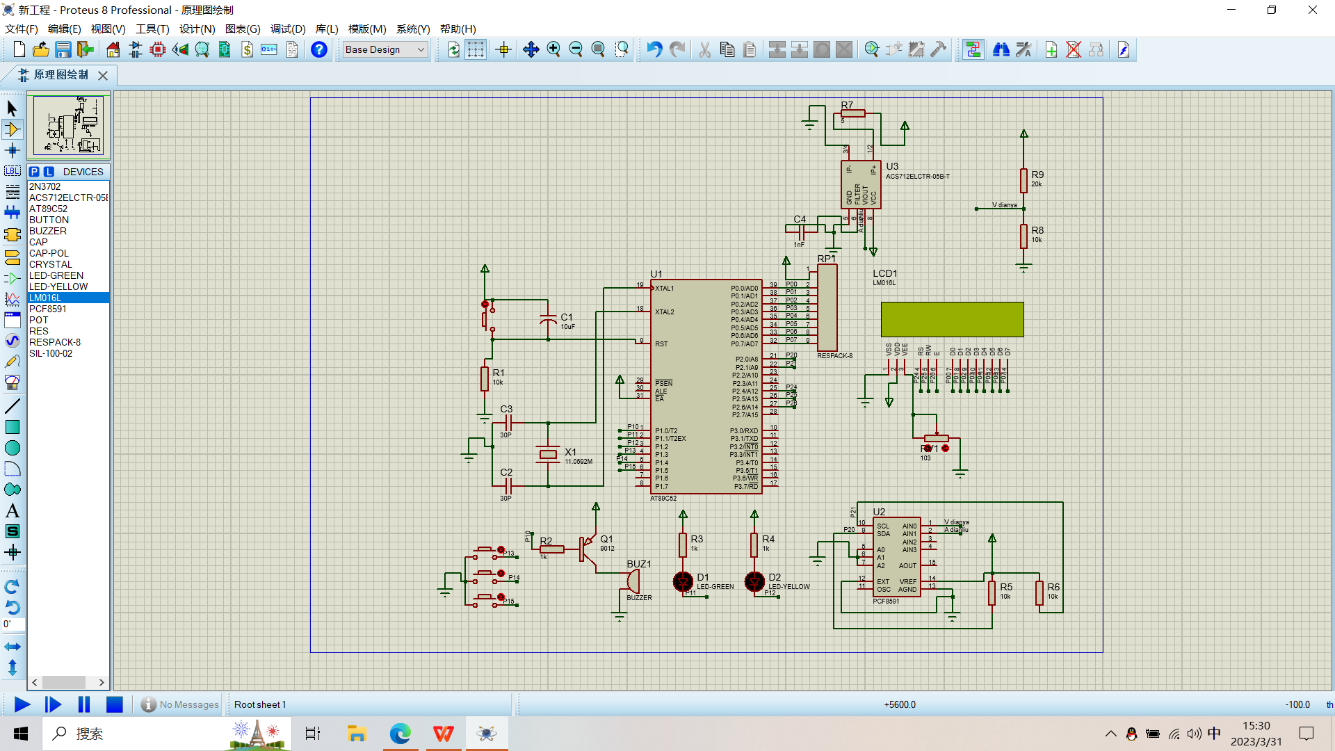

1 #include<reg52.h> //包含头文件,一般情况不需要改动,头文件包含特殊功能寄存器的定义
2 #include<stdio.h>
3 #include "1602.h"
4 #include "delay.h"
5 #include "i2c.h"
6
7 sbit buzzer = P1^0;//蜂鸣器引脚定义
8 sbit led_gre = P1^1; //led灯引脚定义
9 sbit led_yel = P1^2;
10 sbit key1 = P1^3; //按键引脚定义
11 sbit key2 = P1^4;
12 sbit key3 = P1^5;
13
14 char dis0[16]; //打印数组初始化
15 char dis1[16];
16 unsigned long time_20ms=0; //定时器计数
17
18 unsigned char disFlag =0;//定时更新显示
19 unsigned char setFlag =0;
20 float Volt=0.0; //检测电压
21 float Acurrent=0.0; //检测电流
22 unsigned char setV=5;
23 float setA = 0.8;
24 void Init_Timer0(void); //函数声明
25 void uartSendStr(unsigned char *s,unsigned char length);
26 void UART_Init(void);
27 void uartSendByte(unsigned char dat);
28 void keydeal(void) ;
29
30 void main (void)
31 {
32 1 unsigned char midvolt,midcur; //电压电流中间变量值
33 1
34 1 Init_Timer0(); //定时器0初始化
35 1 UART_Init(); //串口初始化
36 1
37 1 LCD_Init(); //初始化液晶
38 1 DelayMs(20); //延时有助于稳定
39 1 LCD_Clear();
40 1 sprintf(dis0,"V:%3.2fv A:%3.2fA",Volt,Acurrent);//打印电压电流值
41 1 LCD_Write_String(0,0,dis0);//显示第二行
42 1 uartSendStr("reday ok!!",10);
43 1 while (1) //主循环
44 1 {
45 2 keydeal();
46 2 if(disFlag == 1)
47 2 {
48 3 disFlag = 0;
49 3 midvolt=ReadADC(1); //读取AD检测到的 电压值
50 3 DelayMs(20); //延时有助于稳定
51 3 midcur=ReadADC(0); //读取、流转化后的电压值
52 3
53 3 Volt=(float)midvolt*5.13/255*3; //计算出电压 *3表示分压值
54 3 Acurrent=(float)midcur*5.13/255; //计算出电流
55 3

64 3 sprintf(dis0,"V:%3.2fv A:%3.2fA",Volt,Acurrent);//打印电压电流值
65 3 LCD_Write_String(0,0,dis0);//显示第二行
66 3
67 3 if(setFlag == 0)
68 3 {
69 4 sprintf(dis1," v:%02d a:%2.1f",(unsigned int)setV,setA);//打印电压电流值
70 4 LCD_Write_String(0,1,dis1);//显示第二行
71 4 }
72 3 else if(setFlag == 1)
73 3 {
74 4 sprintf(dis1,"Sv:%02d a:%2.1f",(unsigned int)setV,setA);//打印电压电流值
75 4 LCD_Write_String(0,1,dis1);//显示第二行
76 4 }
77 3 else if(setFlag == 2)
78 3 {
79 4 sprintf(dis1," v:%02d Sa:%2.1f",(unsigned int)setV,setA);//打印电压电流值
80 4 LCD_Write_String(0,1,dis1);//显示第二行
81 4 }
82 3 if(Acurrent > setA)
83 3 {led_yel = 0;}
84 3 else
85 3 {led_yel = 1;}
86 3 if(Volt > setV)
87 3 {led_gre = 0;}
88 3 else
89 3 {led_gre = 1;}
90 3 if((Acurrent > setA)||(Volt > setV))
91 3 {buzzer = 0;}
92 3 else
93 3 {buzzer = 1;}
94 3 }
