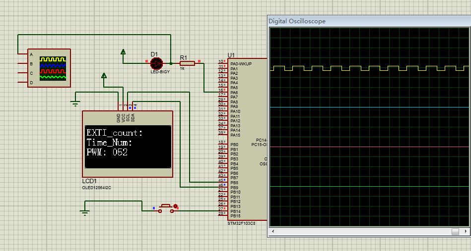

STM32 仿真PWM呼吸灯,要用Proteus8.15及以上版本运行

  5. #include  "timer.h" //定时器中断
  6. #include "PWM.h"    //PWM输出
  7. #include "delay.h"
  8. uint16_t Time_Num =0 ; //定时器中断的计数值
  9. uint16_t i =0 ;
  10. int main(void)
  11. {
  12.         delay_init();
  13.         Led_Init();
  14.         ExtiKey_Init(); //PB14
  15.         OLED_Init();
  16.         Timer_Init();
  17.         PWM_Init();
  18.
  19.         OLED_ShowString(1,1,"EXTI_count: "); //外部中断EXTI(按键)
  20.         OLED_ShowString(2,1,"Time_Num:"); //定时器中断TIM
  21.         OLED_ShowString(3,1,"PWM: ");
  22.
  23.         while(1){
  24.                         for(i=0;i<=100;i++){
  25.                                 PWM_SetCompare1(i); //设置CCR寄存器的值
  26.                                 delay_ms(10);
  27.                                 OLED_ShowNum(3, 6, i , 3);
  28.                         }
  29.                         for(i=0;i<=100;i++){
  30.                                 PWM_SetCompare1(100-i);
  31.                                 OLED_ShowNum(3, 6, 100-i , 3);
  32.                                 delay_ms(10);
  33.                         }
  34.                         OLED_ShowNum(1, 12, ExtiKey_Get(), 5);
  35.                         OLED_ShowNum(2, 10, Time_Num , 5);
  36.
  37.         }
  38. }
