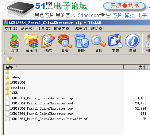

LCD12864_Parrel_ChinaCharacter.zip (168.98 KB, 下载次数: 2157)
