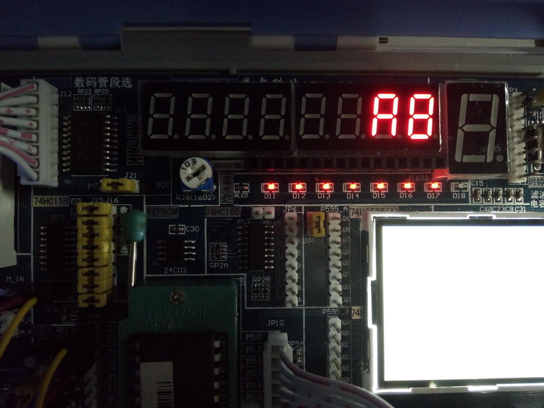

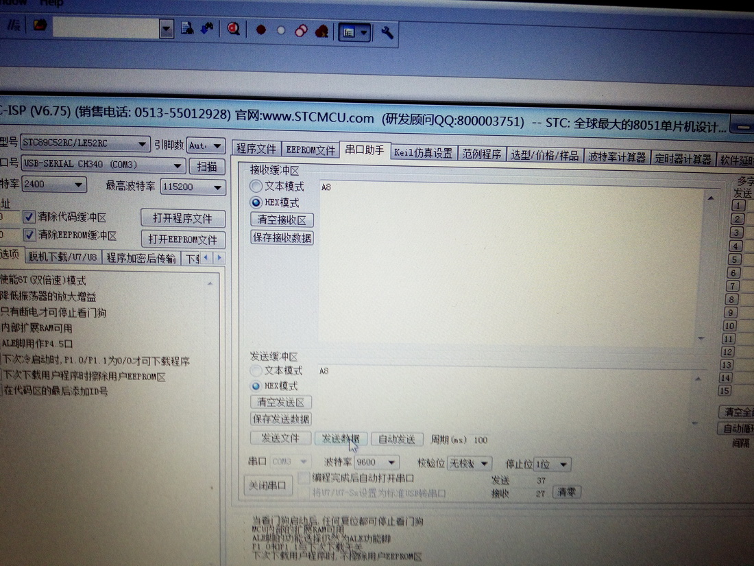

数码管显示串口发送值
已有 782 次阅读2017-10-31 17:43
#include<reg52.h>
sbit ADDR0 = P1^0;
sbit ADDR1 = P1^1;
sbit ADDR2 = P1^2;
unsigned char code LedChar[]={0x3F,0x06,0x5B,0x4F,0x66,0x6D,0x7D,0x07,0x7F,0x6F,0x77,0x7C,0x39,0x5E,0x79,0x71};
unsigned char LedBuff[8] = {
0x00,0x00,0x00,0x00,0x00,0x00,0x00,0x00
unsigned char T0RH = 0;
unsigned char T0RL = 0;
unsigned char RxdByte = 0;
void ConfigTimer0(unsigned int ms);
void ConfigUART(unsigned int baud);
void main()
P0 = 0x00;
EA = 1;
ConfigTimer0(1);
ConfigUART(9600);
LedBuff[7] = LedChar[RxdByte & 0x0F];
LedBuff[6] = LedChar[RxdByte >>4];
unsigned long tmp;
tmp = 11059200/12;
tmp = (tmp*ms)/1000;
tmp = 65536 - tmp;
tmp = tmp + 31;
T0RH = (unsigned char)(tmp>>8);
T0RL = (unsigned char)tmp;
TMOD &= 0xF0;
TMOD |= 0x01;
TH0 = T0RH;
TL0 = T0RL;
ET0 = 1;
TR0 = 1;
SCON = 0x50;
TMOD &= 0x0F;
TMOD |= 0x20;
TH1 = 256 - (11059200/12/32)/baud;
TL1 = TH1;
ET1 = 0;
ES = 1;
TR1 = 1;
void LedScan()
static unsigned char index = 7;
P0 = 0x00;
P1 = (P1 & 0x00)|index;
P0 = LedBuff[index];
if(index>0)
index--;
else
index = 7;
void InterruptTimer0() interrupt 1
TH0 = T0RH;
TL0 = T0RL;
LedScan();
void InterruptUART()interrupt 4
if(RI)
RI = 0;
RxdByte = SBUF;
SBUF = RxdByte;
if(TI)
TI = 0;
