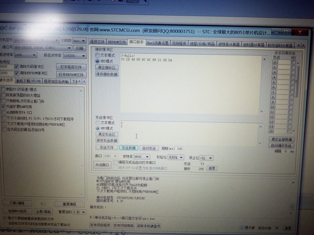

uid:155764 日志
串口显示字符
已有 1636 次阅读2017-10-31 22:57
#include <reg52.h>
bit cmdArrived = 0;   //命令到达标志,即接收到上位机下发的命令
unsigned char cmdIndex = 0; //命令索引,即与上位机约定好的数组编号
unsigned char cntTxd = 0;   //串口发送计数器
unsigned char *ptrTxd = 0;  //串口发送指针
unsigned char array1[] = "1-Hello!\r\n";
unsigned char array2[] = {'2', '-', 'H', 'e', 'l', 'l', 'o', '!', '\r', '\n'};
unsigned char array3[] = {51,  45,  72,  101, 108, 108, 111, 33,  13,   10};
unsigned char array4[] = "4-Hello!\r\n";
void ConfigUART(unsigned int baud);
void main ()
    ConfigUART(9600);  //配置波特率为9600
    EA = 1;  //开总中断
        if (cmdArrived)
            cmdArrived = 0;
            switch (cmdIndex)
                case 1:
                    ptrTxd = array1;         //数组1的首地址赋值给发送指针
                    cntTxd = sizeof(array1); //数组1的长度赋值给发送计数器
                    TI = 1;                //手动方式启动发送中断,处理数据发送
                    break;
                case 2:
                    ptrTxd = array2;
                    cntTxd = sizeof(array2);
                    TI = 1;
                    break;
                case 3:
                    ptrTxd = array3;
                    cntTxd = sizeof(array3);
                    TI = 1;
                    break;
                case 4:
                    ptrTxd = array4;
                    cntTxd = sizeof(array4) - 1;//字符串长度为数组长度减1
                    TI = 1;
                    break;
                default:
                    break;
void ConfigUART(unsigned int baud)  //串口配置函数,baud为波特率
    SCON = 0x50;   //配置串口为模式1
    TMOD &= 0x0F;  //清零T1的控制位
    TMOD |= 0x20;  //配置T1为模式2
    TH1 = 256 - (11059200/12/32) / baud;  //计算T1重载值
    TL1 = TH1;     //初值等于重载值
    ET1 = 0;       //禁止T1中断
    ES  = 1;       //使能串口中断
    TR1 = 1;       //启动T1
void InterruptUART() interrupt 4
    if (RI)  //接收到字节
        RI = 0;           //手动清零接收中断标志位
        cmdIndex = SBUF;  //接收到的数据保存到命令索引中
        cmdArrived = 1;   //设置命令到达标志
    if (TI)  //字节发送完毕
        TI = 0;    //手动清零发送中断标志位
        if (cntTxd > 0)  //有待发送数据时,继续发送后续字节
            SBUF = *ptrTxd;  //发出指针指向的数据
            cntTxd--;        //发送计数器递减
            ptrTxd++;        //发送指针递增
