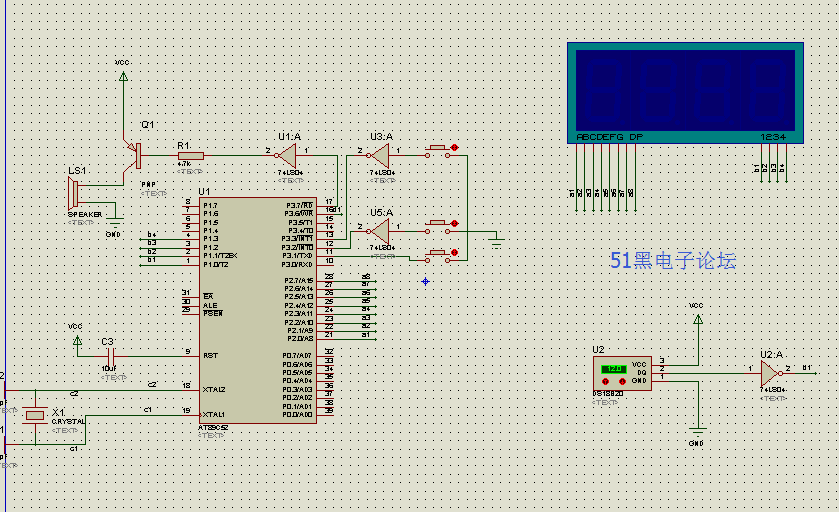

数字温度计单片机课程设计
  1. #include <AT89X52.h>
  2. #include "DS18B20.h"
  3. #define uint unsigned int
  5. #define SET P3_1
  6. #define DEC P3_2
  7. #define ADD P3_3
  8. #define        BEEP P3_7
  9. bit shanshuo_st;
  10. bit beep_st;
  11. sbit DIAN=P2^7;
  12. uchar x=0;
  13. signed char m;
  14. uchar n;
  15. uchar set_st=0;
  16. signed char shangxian=38;
  17. signed char        xiaxian=15;
  18. uchar code
  19. LEDDate[]={0xc0,0xf9,0xa4,0xb0,0x99,0x92,0x82,0xf8,0x80,0x90};

  24. void InitTimer(void)
  25. {
  26. TMOD=0x1;
  27. TH0=0x4c;
  28. TL0=0x00;
  29. }
  30. void timer0(void) interrupt 1
  31. {
  32. TH0=0x4c;
  33. TL0=0x00;
  34. x++;
  35. }
  36. void int0(void) interrupt 0

  127. void main (void)
  128. {
  129. uint z;
  130. InitTimer();
  131. EA=1;
  132. TR0=1;
  133. ET0=1;
  134. IT0=1;
  135. IT1=1;
  136. check_wendu();
  137. check_wendu();
  138. for(z=0;z<300;z++)
  139. {
  140. Disp_init();
  141. }
  142. while(1)
  143. {
  144. if(SET==0)
  145. {
  146. Delay(2000);
  147. do{;}while(SET==0);
  148. set_st++;x=0;shanshuo_st=1;
  149. if (set_st>2)set_st=0;
  150. }
  151. if(set_st==0)
  152. {
  153. EX0=0;
  154. EX1=0;
  155. check_wendu();
  156. Disp_Temperature();
  157. Alarm();
  158. ……………………
  159. …………限于本文篇幅 余下代码请从51黑下载附件…………
