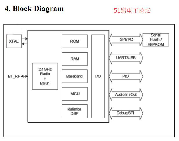

The Bluetooth module provides a complete 2.4GHz Bluetooth system
based on CSR 8615 chip which is a single-chip radio and baseband IC for Bluetooth
2.4GHz systems including basic rate, EDR to 3Mbps and Bluetooth low energy

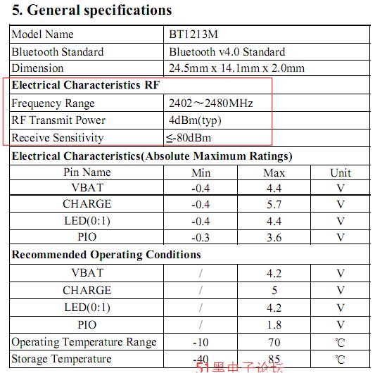

2. Key Features
• Fully Qualified Single-chip Bluetooth® v4.0 System
•-91dBm (typical) π/4 DQPSK receiver sensitivity
  and -81dBm (typical) 8DPSK receiver sensitivity
• A2DP v1.2, multipoint A2DP support enables connection to 2 A2DP
  source devices for music playback
• CSR's latest CVC technology for narrowband and
  wideband voice connections including wind noise reduction
• AVRCP v1.4
• Wideband speech supported by HFP v1.6 and mSBC codec
• PCM and I²S (only in HCI mode) interfaces
• Mono audio DAC
• 5-band fully configurable EQ
• SBC, MP3 and AAC decoder support
• Wired audio support
Supported sample rates of 8, 11.025, 16, 22.05, 32,44.1, 48 and 96kHz (DAC only)
■Bluetooth low energy
•  Dual-mode Bluetooth low energy radio
•  Support for Bluetooth basic rate / EDR and low energy connections
•  3 Bluetooth low energy connections at the same time as basic rate A2DP
• Slim module with 24.5mm x 14.1mm x 2.0mm
• RoHS Compliant

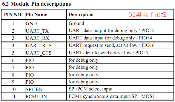

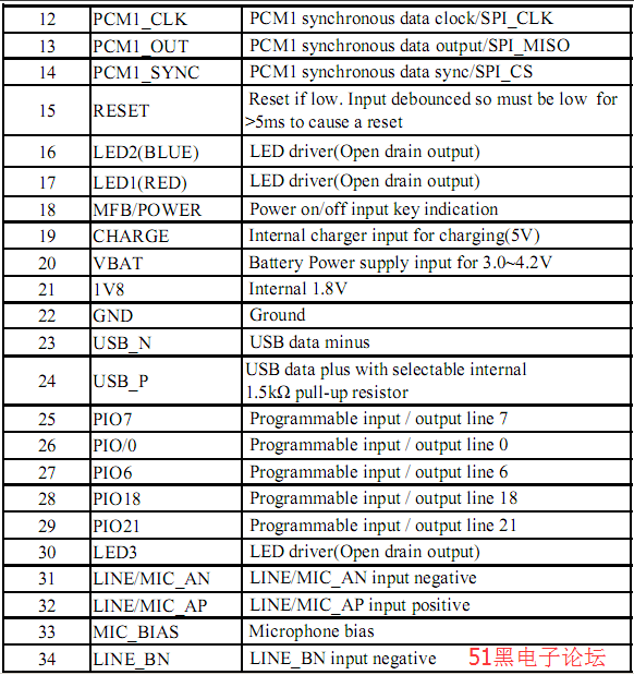

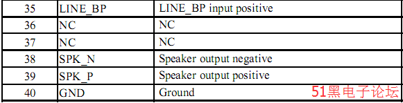

BT1213M管脚功能:

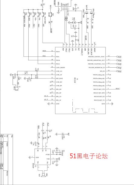

BT1213M典型应用电路:
