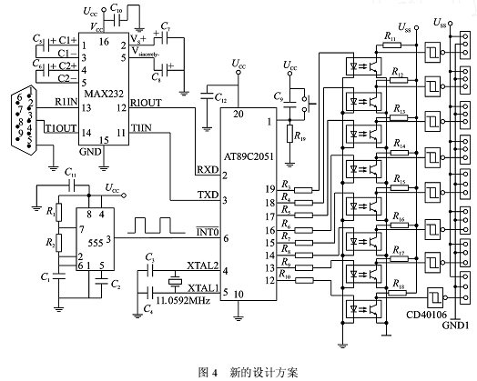

From the Angle of steering gear control method can see, steering gear control signal is an adjustable width of the pulse signal( PWM ). The pulse signal by the FPGA, analog circuits or microcontroller. Adopted FPGA cost is higher, with analog circuit is complicated circuit to realize multiple output, are generally made of steering gear adopts single-chip microcomputer controller. Now do the one-chip computer controller, can use more scheme of microcontroller timer interrupt realize PWM. The plan will be 20 ms periodic signal is divided into two regularly interrupted: a regular realize high-level timing Th, A regular realize low level timing Tl. Th, the time value of Tl with pulse width of transformation and change but Th + Tl = 20 ms. The advantage of this method is completely by MCU, PWM signal inside the timer interruption to realize, need not add peripheral hardware faults is a cycle of PWM signal to interrupt, two for calculating the interruption twice as a trouble, In order to satisfy the cycle, 20 ms chip to reduce the frequency of crystals, Not realizing multi-way output. Can also adopts singlechip + 8253 counter scheme. The scheme of microcomputer produce counting pulse (or an external circuit counting pulse) to count by MCU, 8253 is compared to the count 8253 output pulse-width change the advantages of the plan is to achieve more ways of output, software design is simple, Defect is to add 1 piece 8253 counter, increase the cost of hardware. Based on the combination of the two microcontroller steering gear control scheme is proposed, based on a new design scheme, as shown in figure 4.
The scheme of the controller to AT89C2051 singlechip, consisting of a regular 555 oscillator, SCM based on the pulse signal generated 555 oscillator to generate PWM signal count. This control
The SCM can produce eight PWM channels signal, the P1.0 ~ P1.7 by AT89C2051 (12-19 pin) ports output. The eight PWM signal output by light-coupler to lower level isolation circuit. Because the signal transmitted through light-coupler process, so the signals from light-coupler to inverter reverse phase. Pulse signal transmission through light-coupler, frontier and the distortion, so will happen CD40106 schmidt inverter adopts inverter of optical coupling transmission signals, produce plastic PWM signal. Standard torque-current In the process of experiment, steering gear in the operation process of absorbing from power steering gear and current, if share a microcomputer controller, servo will to power of chip. Therefore, the microcomputer controller and power supply, two by two, not to isolate light-coupler through, and the power supply for steering the output power of switch power. The steering gear controller chip occupy 1 SCI serial port. Serial transmission come to accept a PC control commands,to adjust the output signal of each channel pulse width. MAX232 for level of PC converter, will convert TTL multilevel RS232 level.

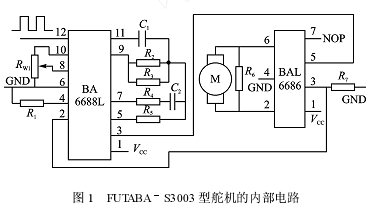

以日本 FUTABA S3003型舵机为例,图1是 FUTABA-S3003 型舵机的内部电路。
舵机的工作原理是:PWM 信号由接收通道进入信号解调电路BA6688L 的12 脚进行解调,获得一个直流偏置电压。该直流偏置电压与电位器的电压比较,获得电压差由BA6688 的 3 脚输出。该输出送入电机驱动集成电路BAL6686,以驱动电机正反转。当电机转速一定时,
通过级联减速齿轮带动电位器 Rw1旋转,直到电压差为0,电机停止转动。舵机的控制信号是 PWM 信号,利用占空比的变化改变舵机的位置。

该方案的舵机控制器以 AT89C2051 单片机为核心,555 构成的振荡器作为定时基准,单片机通过对555 振荡器产生的脉冲信号进行计数来产生 PWM 信号。该控制
器中单片机可以产生 8 个通道的 PWM 信号,分别由AT89C2051 的 P1.0~P1.7(12~19 引脚) 端口输出。输出的8 路 PWM 信号通过光耦隔离传送到下一级电路中。因为信号通过光耦传送过程中进行了反相,因此从光耦出来的信号必须再经过反相器进行反相。方波信号经过光耦传输后,前沿和后沿会发生畸变,因此反相器采用CD40106 施密特反相器对光耦传输过来的信号进行整形,产生标准的 PWM 方波信号。笔者在实验过程中发现,舵机在运行过程中要从电源吸纳较大的电流,若舵机与单片机控制器共用一个电源,则舵机会对单片机产生较大的干扰。因此,舵机与单片机控制器采用两个电源供电,两者不共地,通过光耦来隔离,并且给舵机供电的电源最好采用输出功率较大的开关电源。该舵机控制器占用单片机的1个SCI串口。串口用于接收上位机传送过来的控制命令,以调节每一个通道输出信号的脉冲宽度。MAX232 为电平转换器,将上位机的 RS232 电平转换成 TTL 电平。

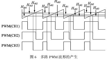

在模拟电路中,PWM 脉冲信号可以通过直流电平与锯齿波信号比较来得到。在单片机中,锯齿波可以通过对整型变量加1 操作来实现,如图5 所示。假定单片机程序
中设置一整型变量 其值变化范围为 ~ 。SawVal , 0 N 555振荡电路产生的外部计数时钟信号输入到 AT89C2051 的INT0脚。每当在外部计数时钟脉冲的下降沿,单片机产生外部中断,执行外部中断INT0的中断服务程序。每产生一次外部中断,对 SawVal 执行一次加1 操作,若 SawVal 已达到最大值 N ,则对 SawVal 清 0。SawVal 值的变化规律相当于锯齿波,如图5 所示。若在单片机程序中设置另一整型变量 DutyVal ,其值的变化范围为 0~N。每当在SawVal 清 0 时,DutyVal 从上位机发送的控制命令中读入脉冲宽度系数值,例如为 H(0 ≤H ≤N)。若DutyVal ≥SawVal,则对应端口输出高电平; 若 DutyVal <SawVal ,则对应端口输出低电平。从图5 中可看出,若改变 DutyVal的值,则对应端口输出脉冲的宽度发生变化,但输出脉冲的频率不变,此即为 PWM波形。
设外部计数时钟周期为 TINT0 ,锯齿波周期(PWM 脉冲周期)为TPWM ,PWM 脉冲宽度占空比为 D,由图5 可得出如下关系:
由式(3)可知,PWM 波形的周期 TPWM一旦确定下来,只须选定计数最大值 N,就可以确定外部时钟脉冲所需周期(频率)。外部时钟脉冲周期 TINT0 显然是 PWM 脉冲宽度变换的最小步距,即调节精度。由式(4)可知,N 越大,步距所占 PWM 周期的百分比越小,精度越高。例如,若8采用8 位整型变量,最大值 N = 2 - 1 =255,则精度为1/16(255 +1) =1/256;若采用16 位整型变量,最大值 N = 2- 1 =65 535,则精度为1/65 536。文中计数变量 SawVal采用8 位整型变量,因此 N =255。对于一般应用,其精度已足够。就舵机而言,要求 TPWM = 20 ms,则可算得外部时钟周期为:
因此,设计555 振荡电路时,其输出脉冲的频率应为:
当有多个变量与 SawVal 比较,将比较结果输出到多个端口时,就形成了多路 PWM 波形。各个变量的值可以独立变化,因此各路 PWM 波形的占空比也可以独立调节,互不相干。多路 PWM 波形的产生如图6 所示。图中以3 路 PWM 波形为例。

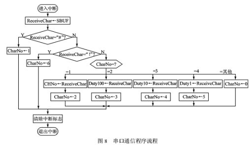

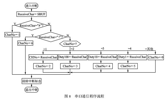

舵机控制器的控制核心为单片机 AT89C2051。文中,程序用 C51 编写,工作方式为前后台工作方式。单片机程序包括系统初始化程序、串口通信程序、上位机命令解释与 PWM 脉宽生成程序和多路 PWM 波形输出程序。串行通信程序和多路 PWM 波形输出程序采用中断方式。串口通信格式为波特率 9 600 bps、8 位数据位、1 位停止位、无校验、ASCII 码字符通信。串口通信程序用于接收上位机发送过来的控制命令。控制命令采用自定义文本协议,即协议内容全部为ASCII码字符。通信协议格式如图7 所示。
例如,要控制通道1 的 PWM 脉宽,脉宽系数为25,则通信协议内容为“#”“1”“0”“2”“5”“!”这6 个字符。这时通道1 的 PWM 占空比为25/256 =0.098。一个通道号对应一个 PWM 脉冲输出端口。本设计为8 个通道,号码为1~8,对应单片机的 P1.0~P1.7。起始符和终止符起到帧同步的作用。串口通信程序流程如图8 所示。
图8 中,CHNo 存放的是 PWM 通道号 ASCII 码,Duty100、Duty10、Duty1 分别存放的是脉宽系数的百位数、十位数和个位数的 ASCII 码(注意,若高位数为 0,则该位的字符应为“0”,不能省略。如25,完整字符应为“0”“2”“5”)。CharNo 为信号量,用于对串口接收的字符顺序以及串口中断与上位机命令解释程序之间进行同步。
