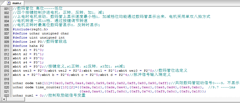

单片机步进电机单双八拍方式控制设计(按键调节转速10档)含电路与源程序
个人整理资料
程序,电路图
  1. //数码管位 高位-----低位
  2. //四个按键控制步进电机:正转,反转,加1,减1
  3. //上电时电机启动,数码管上显示速度最小档1,加减档位均能通过数码管显示出来,电机采用单双八拍方式
  4. //电机转速一共10档,通过按键调节转速
  5. //电机正转时最高位数码管显示0,反转时显示1
  6. #include<reg51.h>
  7. #define uchar unsigned char
  8. #define uint unsigned int
  9. #define led P0//数码管段选
  10. #define haha P2
  11. sbit s1 = P1^0;
  12. sbit s2 = P1^1;
  13. sbit s3 = P3^0;
  14. sbit s4 = P3^1;
  15. sbit s5 = P3^2;//按键定义,s1正转,s2反转,s3加1,s4减1
  16. sbit wei3 = P2^3;sbit wei2 = P2^2;sbit wei1 = P2^1;sbit wei0 = P2^0;//数码管位选定义
  17. sbit a = P2^7;sbit b = P2^6;sbit c = P2^5;sbit d = P2^4;//脉冲信号输入端定义
  18. uchar code tab[11]={0xc0,0xf9,0xa4,0xb0,0x99,0x92,0x82,0xf8,0x80,0x90,0xff};//共阳数码管驱动信号0---9,不显示
  19. uchar code time_counter[10][2]={{0xda,0x1c},{0xde,0xe4},{0xe1,0xec},{0xe5,0xd4},{0xe9,0xbc},  //9.7 ----1ms
  20.                                                             {0xed,0xa4},{0xf1,0x8c},{0xf5,0x74},{0xf9,0x5c},{0xfc,0x18}};
  21. uchar num1 = 0;//控制取励磁信号变量
  22. uchar num2 = 8;
