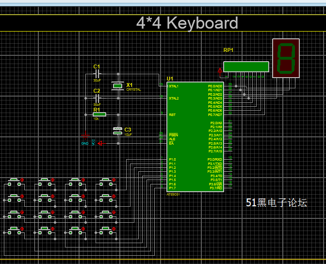

51单片机4*4矩阵键盘proteus仿真与源码
基于AT89S52单片机的4*4矩阵键盘程序

    File:   key44.h
    Date:Loser007       May 5, 2018 12:59
#ifndef __KEY44_H__
#define __KEY44_H__
#pragma SAVE
#pragma REGPARMS
extern char Matrix_keyboard(void);
    Features:   Get a case from the 4*4 keyboard
    Parameter: No
    Return:Key code (char)
    Instructions:Keyboard I/0 From P1^0 to P1^7
    Date:Loser007       May 5, 2018 10:40
    unsigned char Key = 0, X = 0, Y = 0;
    P1 = 0xF0;  //11110000
    X = P1 & 0xF0;  //Get row   (P1 XOR 11110000) Get Height
    if(X != 0xF0)
        X = P1 ^ 0xF0;
        P1 = 0x0F;  //00001111
        Y = P1 & 0x0F;
        if(Y != 0x0F)
            Y = P1 ^ 0x0F;  //Get Column    (P1 XOR 00001111) Get Low
            Key = X + Y;
    switch (Key)
    // 1
    case 0x81:
        return 0;   //1000 0001
    case 0x82:
        return 1;   //1000 0010
    case 0x84:
        return 2;   //1000 0100
    case 0x88:
        return 3;   //1000 1000
    // 2
    case 0x41:
        return 4;   //0100 0001
    case 0x42:
        return 5;   //0100 0010
    case 0x44:
        return 6;   //0100 0100
    case 0x48:
        return 7;   //0100 1000
    // 3
    case 0x21:
        return 8;   //0010 0001
    case 0x22:
        return 9;   //0010 0010
    case 0x24:
        return 10;  //0010 0100
    case 0x28:
        return 11;  //0010 1000
    //4
    case 0x11:
        return 12;  //0001 0001
    case 0x12:
        return 13;  //0001 0010
    case 0x14:
        return 14;  //0001 0100
    case 0x18:
        return 15;  //0001 1000
    default:
        return 255;
#endif
