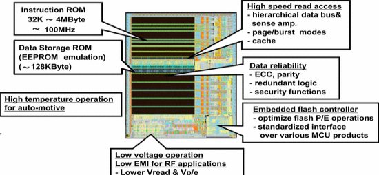

图6.描述了在嵌入式闪存设计中的关键的结构和电路技术。在代码存储应用程序中频繁读取的代码,非升压字线利用分裂栅单元结构有望提高随机读取访问速度和低功耗。在充电泵电路的编程/擦除操作会显著影响嵌入式闪存的低功耗设计。因为闪存技术在降低编程/擦除电压方面存在固有的缺点,因此,高能效的编程/擦除算法和优化产生的高压波形来缓解过度功耗的问题对于节能设计是非常重要的。
图7.展示了目前使用分裂栅MONOS嵌入式闪存技术的单片机产品系列,在芯片上500k的EEPROM的编程/擦除容量以高达100MHz的读取访问都低于Tj=160(max)。电池驱动的运行电压范围低至1.62V。
图6.嵌入式设计中主要的考虑方向

Fig. 6 depicts key architecture and circuit technologies in eFlash designs. In frequent read operations in the code storage applications, non-boosted word-line utilizing a split-gate cell structure is promising to enhance the random read access speed and for low-power consumptions. Lowe-power design in eFlash is strongly affected by the charge-pumping circuitry in program/erase operations. Because flash memory technologies have inherent difficulty in scaling down the program/erase voltage, energy-efficient program/erase algorithms and optimally generated high-voltage waveforms to mitigate excessive power consumption are important in power-aware designs.
Fig. 7 shows a current MCU product line-up employing a split-gate MONOS eFlash technology, with up to 100MHz read access at code storage with 500K program/erase capability in EEPROM on the chip, all under. The operating voltage ranges down to 1.62V for battery operations.
Fig. 6. Key considerations in eFlash design[8], [9].
