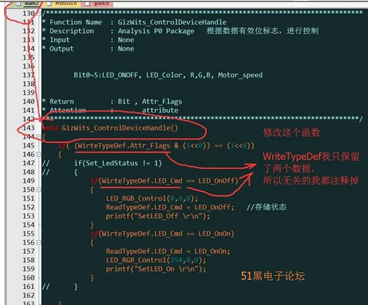

//4.8  WiFi读取MCU. Cmd=0x03
//4.10 WiFi控制MCU. Cmd=0x03
         case Pro_W2D_P0_Cmd:   //就是这里
             switch(UART_HandleStruct.Message_Buf[sizeof(Pro_HeadPartTypeDef)])     //标准报头后紧跟一个action(1B)
                    //4.10 WiFi控制MCU. Cmd=0x03 ActionBit=0x01
                     case P0_W2D_Control_Devce_Action:
                         Pro_W2D_CommonCmdHandle();  //回复通用协议帧
                        //储存ActionBit之后的信息到Message_Buf,最终传给WriteTypeDef来更改MCU设备状态
                         memcpy(Message_Buf, UART_HandleStruct.Message_Buf+sizeof(Pro_HeadPartP0CmdTypeDef), Length_buf);
                         p0Flag = 1;   //main()里,依靠此标志,和WriteTypeDef来控制更改设备状态
                         break;
                        //4.8 WiFi读取MCU. Cmd=0x03 ActionBit=0x02
                         case P0_W2D_ReadDevStatus_Action:
                         Pro_W2D_ReadDevStatusHandle();
                         break;
                         default:
                             break;
         break;
废话不多说,上几张图,大家看代码吧。
