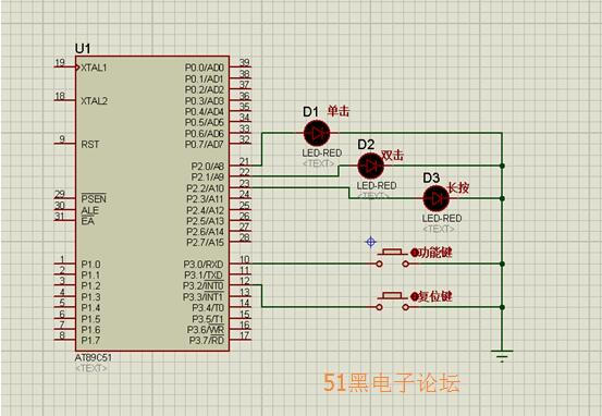

分享51单片机实现的双击     单击    长按   的按键判断   C51代码
电路原理图如下:
  1. #include<reg51.h>
  2. sbit key = P3^0;
  3. sbit led1 = P2^0;
  4. sbit led2 = P2^1;
  5. sbit led3 = P2^2;
  6. sbit key_over = P3^2;
  7. unsigned char x = 0,y = 0;
  8. ///////////////---------子函数声明-----------////////////
  9. void init(void);                   //初始化定时器0
  10. void delay(unsigned int a);        //延时
  11. void key_main(void);               //按键事件判断
  12. ///////////////-----------主函数-----------//////////
  13. void main()
  14. {
  15.         init();
  16.         key_main();
  17. }
  18. void init(void)    //初始化定时器0
  19. {
  20.         TMOD = 0x01;
  21.         IT0 = 1;      ///低电平有效
  22.         TH0 = (65536-50000)/256;
  23.         TL0 = (65536-50000)%256;
  24.         EA = 1;
  25.         ET0 = 1;
  26.         EX0 = 1;
  27.         key = 1;      //初始化按键
  28.         P2 = 0x00;
  29.
  30. }
  31. void key_main(void)     //按键事件判断
  32. {
  33.         while(1)
  34.         {
  35.         new:if(key == 0)
  36.                 {
  37.                         delay(10);
  38.                         if(key == 0)
  39.                         {
  40.                                 TR0 = 1;
  41.                                 while(key == 0);     ///第一次按键释放
  42.                                 TR0 = 0;
  43.                                 if(x>16)             //判断是否为长按
  44.                                 {
  45.                                         x = 0;
  46.                                         led3 = 1;
  47.
  48.                                         goto new;
  49.                                 }
  50.                                 x = 0;
  51.                                 TR0 = 1;
  52.
  53.                                 while(x<=6)              //在第一次按键事件完成后,若0.5秒内无按键事件,则为单击,否则是双击
  54.                                 {
  55.                                         if(key == 0)
  56.                                         {
  57.                                                 delay(10);
  58.                                                 if(key == 0)
  59.                                                 {
  60.                                                         TR0 = 0;
  61.                                                         x = 0;
  62.                                                         while(key == 0);
  63.                                                         led2 = 1;
  64.
  65.                                                         goto new;
  66.                                                 }
  67.                                         }
  68.                                 }
  69.                                 TR0 = 0;
  70.
  71.                                 if(x != 0)
  72.                                 {
  73.                                         x = 0;
  74.                                         led1 = 1;
  75.
  76.                                         goto new;
  77.                                 }
  78.                         }
  79.                 }
  80.         }
  81. }
  82. void delay(unsigned int a)       //延时
  83. {
  84.         unsigned int i;
  85.         for(a;a>0;a--)
  86.                 for(i=110;i>0;i--)
  87.                         ;
  88. }
  89. void time(void) interrupt 1      ///定时器0
  90. {
  91.         ET0 = 0;
  92.         {
  93.                 TH0 = (65536-50000)/256;
  94.                 TL0 = (65536-50000)%256;
  95.                 x += 1;
  96.         }
  97.         ET0 = 1;
  98. }
  99. void over(void) interrupt 0      ///外部中断
  100. {
  101.         ET0 = 0;
  102.         {
  103.                 if(led1 == 1)
  104.                         led1 = 0;
  105.                 if(led2 == 1)
  106.                         led2 = 0;
  107.                 if(led3 == 1)
  108.                         led3 = 0;
  109.         }
  110.         ET0 = 1;
  111. }
