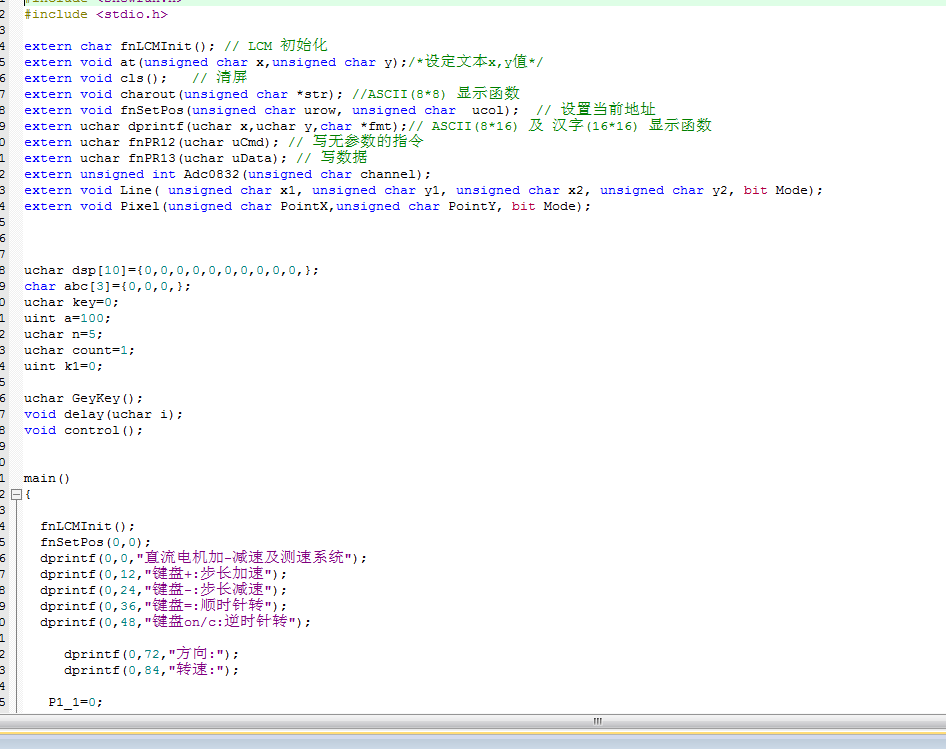

  1. #include <showfun.h>
  2. #include <stdio.h>
  3. extern char fnLCMInit(); // LCM 初始化
  4. extern void at(unsigned char x,unsigned char y);/*设定文本x,y值*/
  5. extern void cls();         // 清屏
  6. extern void charout(unsigned char *str); //ASCII(8*8) 显示函数
  7. extern void fnSetPos(unsigned char urow, unsigned char  ucol);        // 设置当前地址
  8. extern uchar dprintf(uchar x,uchar y,char *fmt);// ASCII(8*16) 及 汉字(16*16) 显示函数
  9. extern uchar fnPR12(uchar uCmd); // 写无参数的指令
  10. extern uchar fnPR13(uchar uData); // 写数据
  11. extern unsigned int Adc0832(unsigned char channel);
  12. extern void Line( unsigned char x1, unsigned char y1, unsigned char x2, unsigned char y2, bit Mode);
  13. extern void Pixel(unsigned char PointX,unsigned char PointY, bit Mode);
  14. uchar dsp[10]={0,0,0,0,0,0,0,0,0,0,};
  15. char abc[3]={0,0,0,};
  16. uchar key=0;
  17. uint a=100;
  18. uchar n=5;
  19. uchar count=1;
  20. uint k1=0;
  21. uchar GeyKey();
  22. void delay(uchar i);
  23. void control();
  24. main()
  25. {
