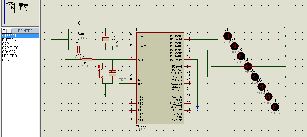

AT89c51单片机流水灯实验
#include<reg52.h>             //库文件
void Delay(unsigned int ms)//ms延时程序
   int i,j;
   for(i=0;i<ms;i++)
     for(j=0;j<100;j++)
void main(void)
    unsigned char i;
    unsigned char code Tab[ ]={0xfe,0xfc,0xf8,0xf0,0xe0,0xc0,0x80,0x00,};
        for(i=0;i<8;i++)
            P0=Tab[ i];
            Delay(100);
简单流水灯程序和仿真图.zip
