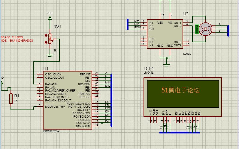

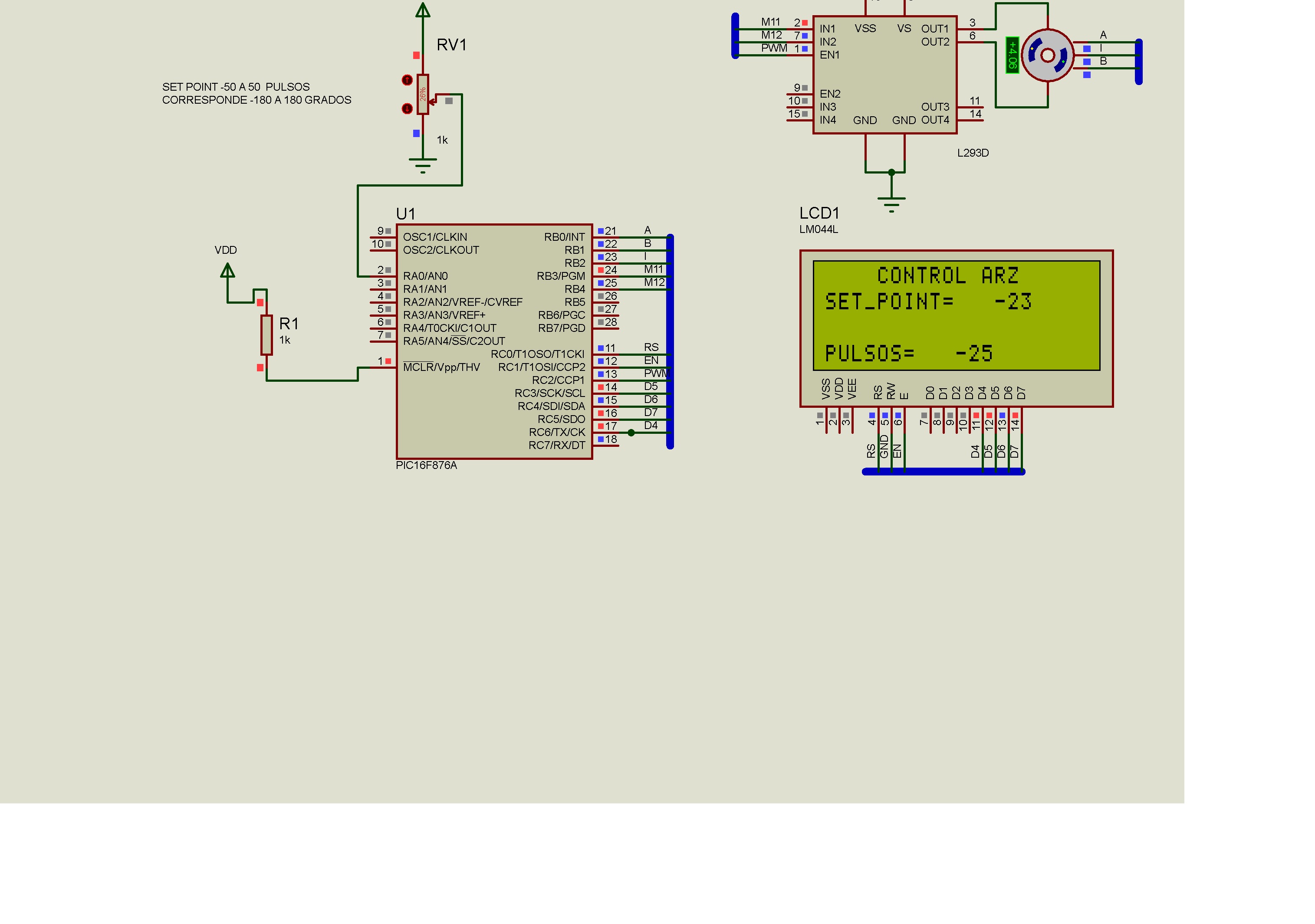

PID SERVO CONTROL
SET POINT -50 A 50  PULSOS
CORRESPONDE -180 A 180 GRADOS
