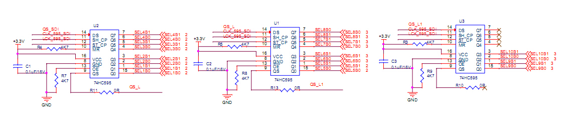

基于arduino d1炫彩灯
电路
源代码

const byte Pin_DS = D6;     //data Pin
const byte Pin_STCP = D7;   //bitOrder Pin
const byte Pin_SHCP = D8;   //clock Pin

void led_Display(short AB, short CD, short EF) {
  //Serial.print("LED 值 AB:"); Serial.println(AB, BIN);
  //Serial.print("LED 值 CD:"); Serial.println(CD, BIN);
  //Serial.print("LED 值 EF:"); Serial.println(EF, BIN);
  digitalWrite(Pin_STCP, LOW);
  //MSBFIRST,从高到底传输二进制位,74HC595会从第一块开始,从Q0一直位移数据到Q7,如果还有数据,则继续把压到第二块的Q0到Q7,如果还有数据,则继续把压到第三块的Q0到Q7
  //MSBFIRST的方式,这里才是第四块的数据
  shiftOut(Pin_DS, Pin_SHCP, LSBFIRST , 0) ;
  //MSBFIRST的方式,这里才是第三块的数据
  shiftOut(Pin_DS, Pin_SHCP, LSBFIRST , EF) ;
  //MSBFIRST的方式,这里才是第二块的数据
  shiftOut(Pin_DS, Pin_SHCP, LSBFIRST , CD) ;
  //MSBFIRST的方式,这里才是第一块的数据
  shiftOut(Pin_DS, Pin_SHCP, LSBFIRST , AB) ;
  digitalWrite(Pin_STCP, HIGH);
  Serial.println("LED 灯设置成功!"); Serial.println(EF, BIN);
  long tmp = (tmp << 8) | AB;
  tmp = (tmp << 8) | CD;
  tmp = (tmp << 8) | EF;
  Serial.print("LED 设置值:"); Serial.println(tmp, BIN);
