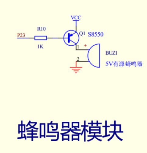

单片机蜂鸣器制作音乐
#include <at89x52.h>
#define uchar unsigned char
bit flag; //标志音乐输出脚电平的高低
uchar ptr = 0x00; //取音符
uchar high; //计数器高位
uchar low; //计数器低位
// 本曲谱为 "新年好",前两个十六进制表示发声频率,后一个表示发声时间,0xFF,0xFF 表示休止符
// 0x00 表示结束
// 1 _ 1_ 1 .5
uchar code music[] = {
0xFC,0x44,0x7F, 0xFC,0x44,0x7F, 0xFC,0x44,0xFF, 0xFA,0x68,0xFF,
// 3 _ 3_ 3 1
0xFD,0x23,0x7F, 0xFD,0x23,0x7F, 0xFD,0x23,0xFF, 0xFC,0x44,0xFF,
// 1_ 3_ 5 5
0xFC,0x44,0x7F, 0xFD,0x23,0x7F, 0xFD,0x82,0xFF, 0xFD,0x82,0xFF,
// 4_ 3_ 2 -
0xFD,0x23,0x7F, 0xFD,0x23,0x7F, 0xFC,0xAC,0xFF, 0xFF,0xFF,0xFF,
// 2_ 3_ 4 4
0xFC,0xAC,0x7F, 0xFD,0x23,0x7F, 0xFD,0x34,0xFF, 0xFD,0x34,0xFF,
// 3_ 2_ 3 1
0xFD,0x23,0x7F, 0xFC,0xAC,0x7F, 0xFD,0x23,0xFF, 0xFC,0x44,0xFF,
// 1_ 3_ 2 .5
0xFC,0x44,0x7F, 0xFD,0x23,0x7F, 0xFC,0xAC,0xFF, 0xFA,0x68,0xFF,
// .7_ 2_ 1 -
0xFC,0x0C,0x7F, 0xFC,0xAC,0x7F, 0xFC,0x44,0xFF, 0xFF,0xFF,0xFF,
0x00//结束

* 名称:Count1(void) interrupt 1
* 功能:设置计时器0 溢出中断,每中断一次改变P2_3 引脚电平
void Count1(void) interrupt 1
        TH0 = high;
        TL0 = low;
        if (flag == 0) //改变P2_3 引脚电平
                P2_3 = 0;
                flag = 1;
        else
                P2_3 = 1;
                flag = 0;
* 名称:Init()
* 功能:设置计数器0 工作方式,16 位计数,溢出中断方式
void Init()
        TMOD = 0x01; //定时器0 处于计时方式,16 位
        EA = 1;
        ET0 = 1; //定时器0 溢出中断
