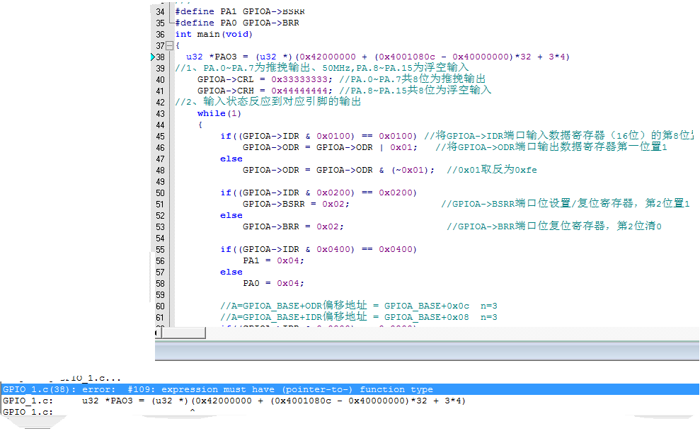

STM32 keil编译产生错误,求帮助
# include "sys.h"
#define PA1 GPIOA->BSRR
#define PA0 GPIOA->BRR
int main(void)
  u32 *PAO3 = (u32 *)(0x42000000 + (0x4001080c - 0x40000000)*32 + 3*4)
//GPIO_1.c(38): error:  #109: expression must have (pointer-to-) function type
上一句为代码,下一句是keil编译后生成的错误,烦请各路大神给看下错误出在哪里,谢谢!
错误内容:
报错图片
报错图片
ID:277374 发表于 2018-10-13 09:58 | 只看该作者
u32 *PAO3 = (u32 *)(0x42000000 + (0x4001080c - 0x40000000)*32 + 3*4)     这句话后边是需要加上分号的,标识本句结束
