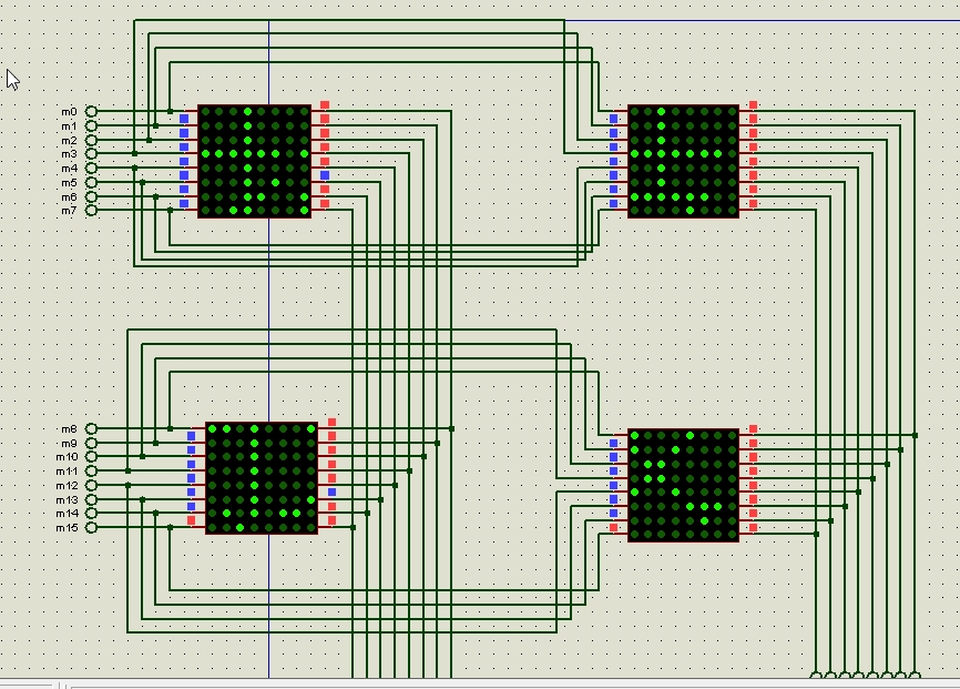

16*16点阵 循环滚动播放protues仿真和51单片机源代码
ID:409542 发表于 2018-11-21 19:26 | 显示全部楼层 |阅读模式
  1. #include<reg51.h>
  3. #define uint unsigned int
  4. #define out1 P1
  5. #define out0 P0
  6. #define out2 P2
  7. void delay(uint j)
  8. {
  9.         uchar i=250;
  10.         for(;j>0;j--)
  11.         {
  12.                 while(--i);
  13.                 i=100;
  14.         }
  15. }
  16. uchar code string[]=
  17. {
  18.                 0x7F,0xFF,0x7F,0xFF,0x7F,0xFF,0x03,0xE0,0x7B,0xEF,0x7B,0xEF,0x03,0xE0,0x7B,0xEF,
  19.                 0x7B,0xEF,0x7B,0xEF,0x03,0xE0,0x7B,0xEF,0x7F,0xBF,0x7F,0xBF,0xFF,0x00,0xFF,0xFF,
  20.         //
  21.                 0xFF,0xFF,0x03,0xF0,0xFF,0xFB,0xFF,0xFD,0xFF,0xFE,0x7F,0xFF,0x7F,0xFF,0x7F,0xDF,
  22.                 0x00,0x80,0x7F,0xFF,0x7F,0xFF,0x7F,0xFF,0x7F,0xFF,0x7F,0xFF,0x5F,0xFF,0xBF,0xFF,
  23.         //
  24.                 0xF7,0xFB,0xF7,0xFB,0xF7,0xFB,0x40,0x80,0xF7,0xFB,0xD7,0xFB,0x67,0xC0,0x73,0xEF,
  25.                 0x74,0xEE,0xF7,0xF6,0xF7,0xF9,0xF7,0xF9,0xF7,0xF6,0x77,0x8F,0x95,0xDF,0xFB,0xFF,
  26.         //
  27.                 0x7F,0xFF,0x7F,0xFB,0x7F,0xF7,0x7F,0xFF,0x00,0x80,0x7F,0xFF,0x3F,0xFE,0x5F,0xFD,
  28.                 0x5F,0xFB,0x6F,0xF7,0x77,0xE7,0x7B,0x8F,0x7C,0xDF,0x7F,0xFF,0x7F,0xFF,0xFF,0xFF
  29. };
  30.
  31. void main()
  32. {
  33.         uchar i,j,n;
  34.         while(1)
  35.         {
  36.                 for(j=0;j<4;j++)
  37.                 {
  38.                         for(n=0;n<40;n++)
  39.                         {
  40.                                 for(i=0;i<16;i++)
  41.                                 {
  42.                                         out1=i%16;
  43.                                         out0=string[i*2+j*32];
  44.                                         out2=string[i*2+1+j*32];
  45.                                         delay(4);
  46.                                         out0=0xff;
  47.                                         out2=0xff;
  48.                                 }
  49.                         }
  50.                 }
  51.         }
  52. }

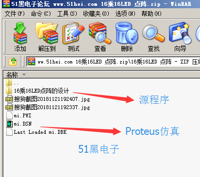

所有资料51hei提供下载:
16乘16LED 点阵.zip (622.01 KB, 下载次数: 18)
