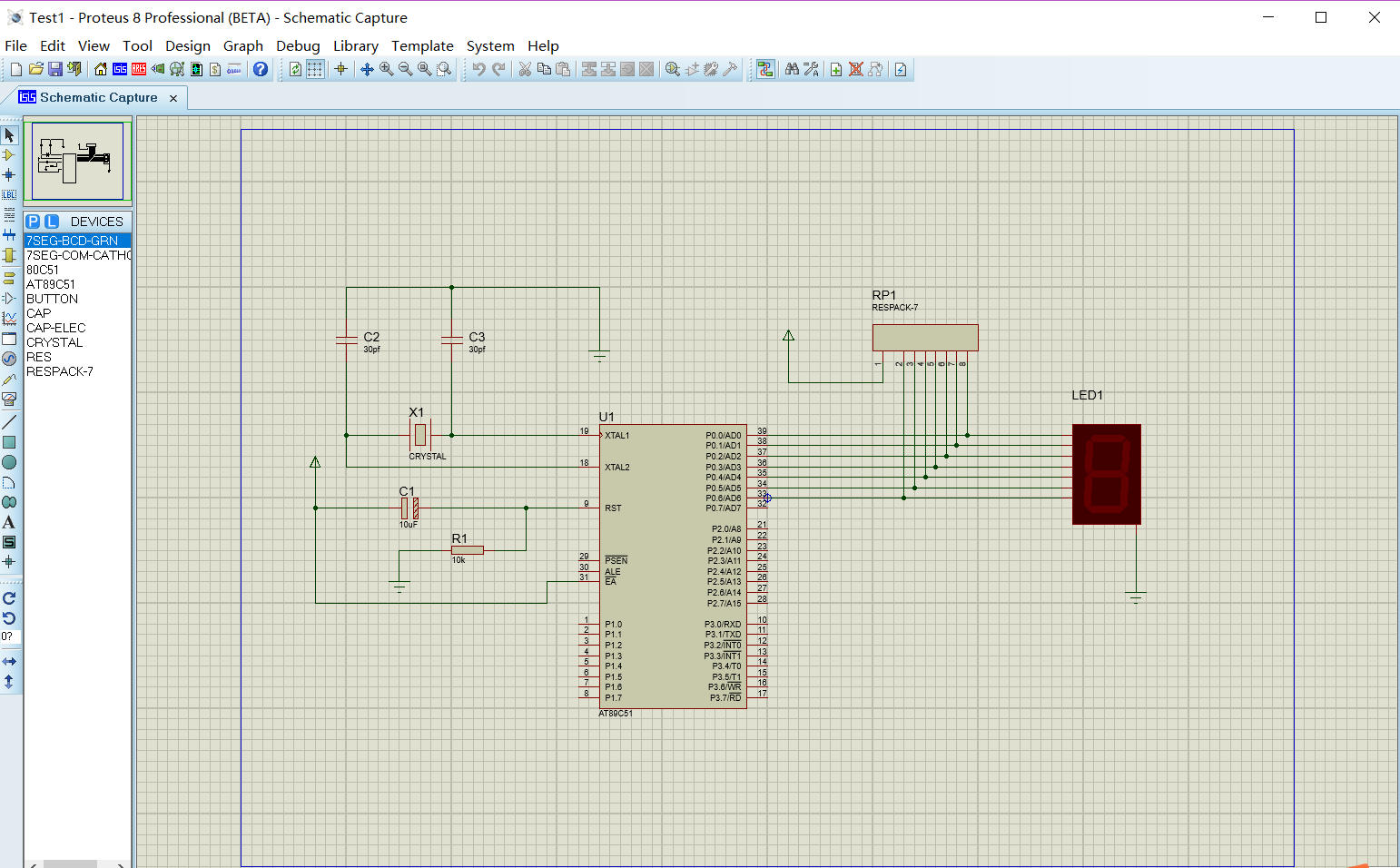

单片机控制LED灯从0到8循环显示程序
单片机源码:
  1. #include <reg51.h>
  2. char led_mod[]={0x3f,0x06,0x5b,0x4f,0x66,0x6d,0x7d,0x07,0x7f,0x6f};
  3. void delay(unsigned int time) {
  4.          unsigned int j=0;
  5.         for(;time>0;time--)
  6.                 for(j=0;j<125;j++);
  7. }
  8. void main(void) {
  9.         char i=0;
  10.         while(1) {
  11.                 for(i=0;i<=9;i++) {
  12.                         P0=led_mod[i];
  13.                         delay(500);
  14.                 }
  15.         }
  16. }
