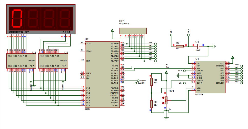

adc0804输出一直为高电平,不知道是单片机程序问题还是硬件连接问题
adc0804输出一直为高,不知道是程序问题还是硬件连接问题,求解
#include<reg51.h>
#include<intrins.h>
//sbit Cs=P2^0;
sbit Write=P2^1;
sbit Read=P2^2;
sbit WeiEN=P2^6;
sbit DuanEN=P2^7;
  unsigned char num;
unsigned char DuanMa[]= //段码数组为从0到9
                {0x3f,0x06,0x5b,0x4f,0x66,0x6d,
                0x7d,0x07,0x7f,0x6f};
unsigned char WeiXuan[]={0xfe,0xfd,0xfb,0xf7};//位选
void delay(unsigned int xMs)
{ unsigned char x,y;
  for(x=xMs;x>0;x--)
    for(y=110;y>0;y--);
void xianshi(num)
{ unsigned char        bai,shi,ge;
  bai=num/100;
  shi=num%100/10;
  ge=num%10;
  WeiEN=1;P1=WeiXuan[0];WeiEN=0; P1=0x00;
  DuanEN=1;P1=DuanMa[bai];DuanEN=0;delay(1000);
  WeiEN=1;P1=WeiXuan[1];WeiEN=0; P1=0x00;
  DuanEN=1;P1=DuanMa[shi];DuanEN=0;delay(1000);
  WeiEN=1;P1=WeiXuan[2];WeiEN=0;P1=0x00;
  DuanEN=1;P1=DuanMa[ge];DuanEN=0;delay(1000);
void write()
    Write=1;_nop_(); Write=0;_nop_(); Write=1;
        //一个下降沿
unsigned char read()
{  unsigned char num;
    P0=0XFF;           //先将P0口全部置1
    Read=1;_nop_();Read=0; _nop_(); num=P0; Read=1;
      //上升沿之前将数值转化为中间变量num
          return num;
int main()
{ //Cs=0;//片选
WeiEN=0;
DuanEN=0;//防止第一次显示错误
  write();
  xianshi(num);
  read();

unsigned char read()函数中重定义  unsigned char num; 全局变量num始终为0,显示000。
sbit Write=P2^1;sbit Read=P2^2;与电路图不符,应为sbit Write=P2^2;sbit Read=P2^1;
