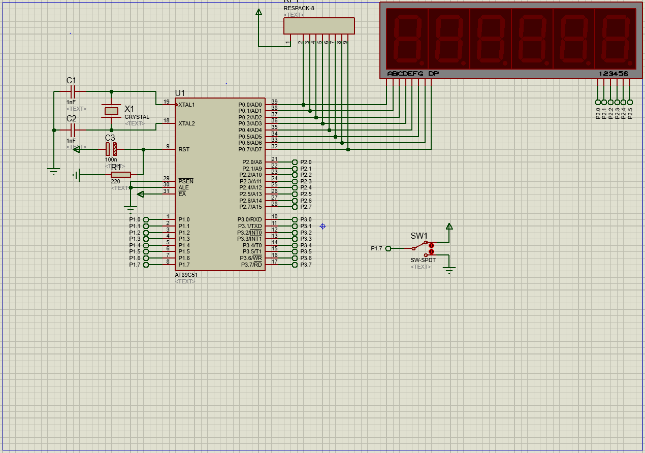

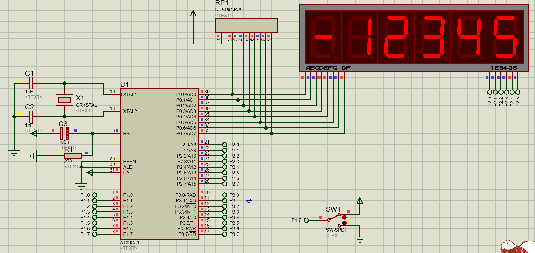

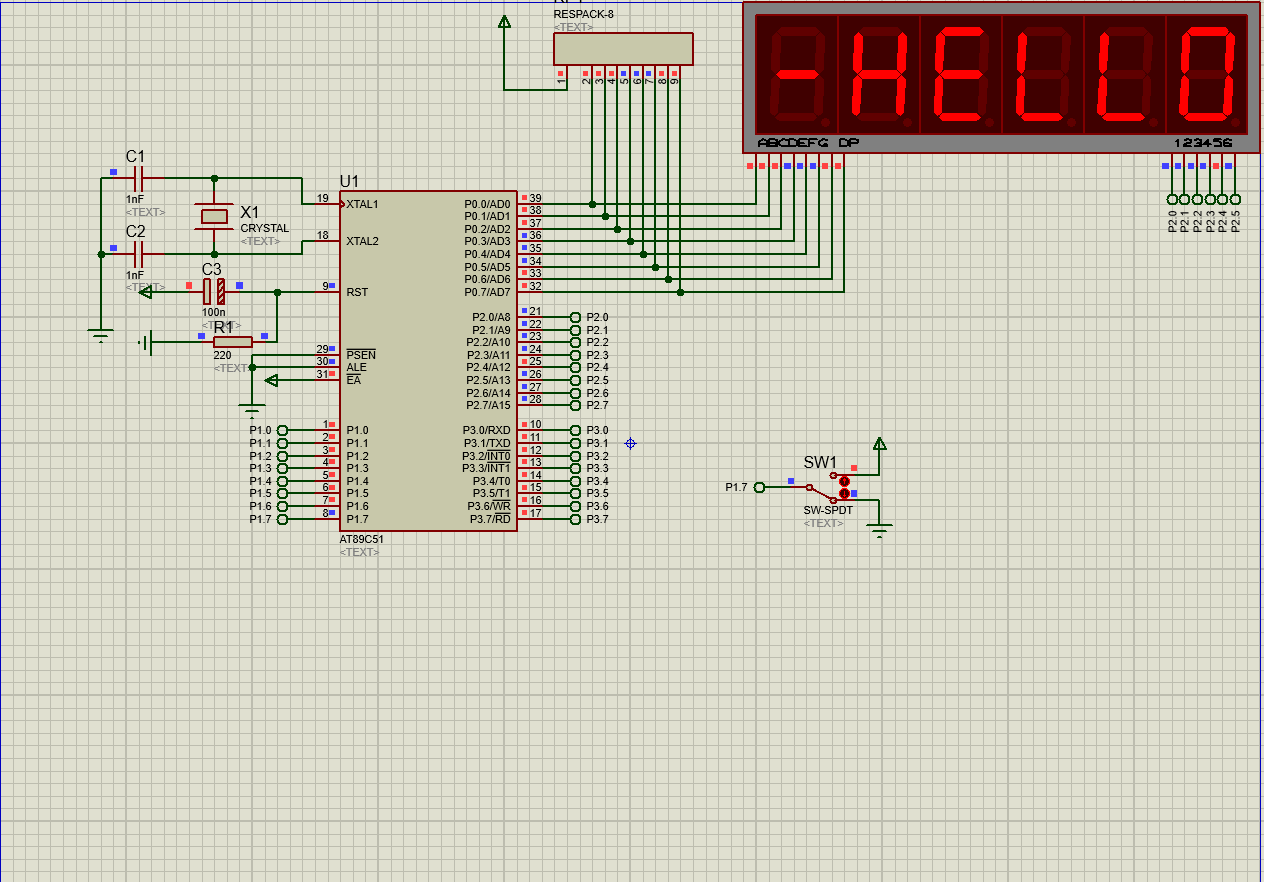

萌新制作的简单单片机仿真程序 供新人参考(在英文hello和数字1234之间变化)
  1. #include<AT89X51.H>
  2. unsigned char code table1[]={0xbf,0xf9,0xa4,0xb0,0x99,0x92};
  3. unsigned char code table2[]={0xbf,0x89,0x86,0xc7,0xc7,0xc0};
  4. unsigned char code table3[]={0x01,0x02,0x04,0x08,0x10,0x20};
  5. unsigned char i;
  6. unsigned char a,b;
  7. unsigned char temp;
  8. void main(void)
  9. {
  10.    while(1)
  11.    {
  12.         temp=0xfe;
  13.                 for(i=0;i<6;i++)
  14.                 {  P2=table3[i];
  15.                    if(P1_7==1)
  16.                    {
  17.                        P0=table1[i];
  18.                 }
  19.               else
  20.                   {P0=table2[i];
  21.                   }
  22.                   for(a=4;a>0;a--)
  23.                       for(b=248;b>0;b--);
  24.                           }
  25.                         }
  26.                 }
