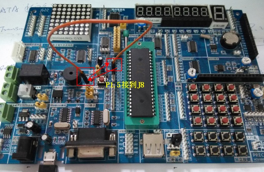

#include "reg52.h"             //此文件中定义了单片机的一些特殊功能寄存器
#include "SoundPlay.h"
#include"music.h"
typedef unsigned int u16;      //对数据类型进行声明定义
typedef unsigned char u8;
void Delay1ms(unsigned int count)
    unsigned int i,j;
    for(i=0;i<count;i++)
    for(j=0;j<120;j++);
void main()
    InitialSound();
        Play(Music_Girl,0,3,360);
        Delay1ms(500);
        Play(Music_Same,0,3,360);
        Delay1ms(500);
        Play(Music_Two,0,3,360);
        Delay1ms(500);
连接图
连接图
