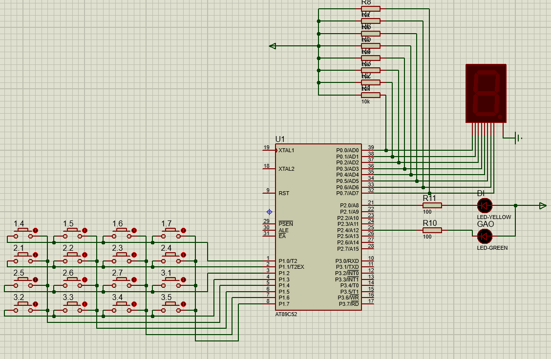

为什么这个单片机4*4按键总是无法识别?核心问题出在那,求帮助
#include <reg52.h>
#define uchar unsigned char
#define uint  unsigned int
uchar temp;
uint i,key,yand;
uchar dispay_[7]={0x06,0x5b,0x4f,0x66,0x6d,0x7d,0x07};
uchar yand_[3]={0xfe,0xef,0xee};
void delay(uint i)
         uint m,n;
        for(m=i;m>0;m--)
                for(n=125;n>0;n--);
void keyscan()
        {P1=0xfe;
        temp=P1;
          if(temp&0xfe!=0xfe)
                {temp=P1;
                        switch(temp)
                         { case 0xee:
                                            key=4;
                                            yand=0;break;
                           case 0xde:
                                            key=5;
                                      yand=0;break;
                                 case 0xbe:
                                            key=6;
                                      yand=0;break;
                                 case 0x7e:
                                            key=7;
                                      yand=0;break;}
P1=0xfd;
        temp=P1;
          if(temp&0xfd!=0xfd)
                {temp=P1;
                        switch(temp)
                         { case 0xed:
                                            key=1;
                                            yand=1;break;
                           case 0xdd:
                                            key=2;
                                      yand=1;break;
                                 case 0xbd:
                                            key=3;
                                      yand=1;break;
                                 case 0x7d:
                                            key=4;
                                      yand=1;break;        }
P1=0xfb;
        temp=P1;
          if(temp&0xfb!=0xfb)
                {temp=P1;
                        switch(temp)
                         { case 0xeb:
                                            key=5;
                                            yand=1;break;
                           case 0xdb:
                                            key=6;
                                      yand=1;break;
                                 case 0xbb:
                                            key=7;
                                      yand=1;break;
                                 case 0x7b:
                                            key=1;
                                      yand=2;break;}
P1=0xf7;
        temp=P1;
          if(temp&0xf7!=0xf7)
                {temp=P1;
                        switch(temp)
                         { case 0xe7:
                                            key=2;
                                            yand=2;break;
                           case 0xd7:
                                            key=3;
                                      yand=2;break;
                                 case 0xb7:
                                            key=4;
                                      yand=2;break;
                                 case 0x77:
                                            key=5;
                                      yand=2;break;
void diapay()
        P2=yand_[yand];
        P0=dispay_[key-1];
void main()
         keyscan();
        diapay();

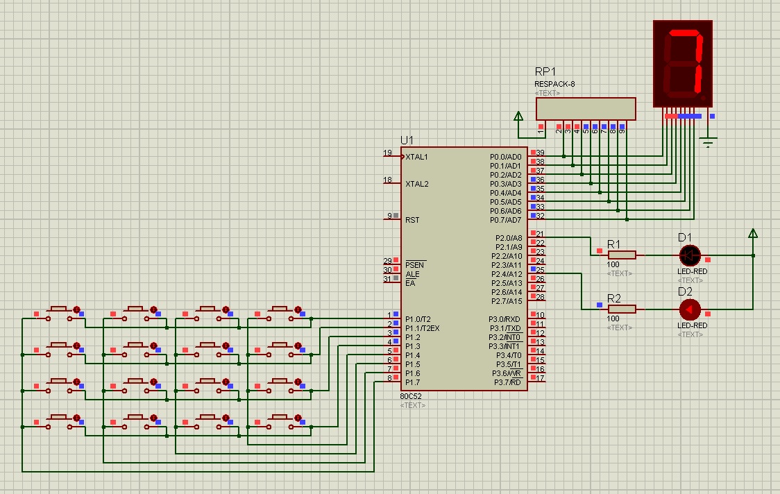

ID:213173 发表于 2019-5-29 07:23 | 只看该作者
你把程序对比一下就知道问题在哪
  1. #include <reg52.h>
  3. #define uint  unsigned int
  4. uchar temp;
  5. uchar i,key,yand;
  6. uchar dispay_[]={0x3f,0x06,0x5b,0x4f,0x66,0x6d,0x7d,0x07};
  7. uchar yand_[3]={0xfe,0xef,0xee};
  8. void delay(uint i)
  9. {
  10.         uint m,n;
  11.         for(m=i;m>0;m--)
  12.                 for(n=125;n>0;n--);
  13. }
  14. void keyscan()
  15. {
  16.         P1=0xf0;
  17.         if(P1!=0xf0)
  18.         {
  19.                 delay(10);
  20.                 if(P1!=0xf0)
  21.                 {
  22.                         temp=P1;
  23.                         temp|=0x0f;
  24.                         P1=temp;
  25.                         switch(P1)
  26.                         {
  27.                                 case 0xee:key=4;yand=0;break;
  28.                                 case 0xde:key=5;yand=0;break;
  29.                                 case 0xbe:key=6;yand=0;break;
  30.                                 case 0x7e:key=7;yand=0;break;
  31.                                 case 0xed:key=1;yand=1;break;
  32.                                 case 0xdd:key=2;yand=1;break;
  33.                                 case 0xbd:key=3;yand=1;break;
  34.                                 case 0x7d:key=4;yand=1;break;
  35.                                 case 0xeb:key=5;yand=1;break;
  36.                                 case 0xdb:key=6;yand=1;break;
  37.                                 case 0xbb:key=7;yand=1;break;
  38.                                 case 0x7b:key=1;yand=2;break;
  39.                                 case 0xe7:key=2;yand=2;break;
  40.                                 case 0xd7:key=3;yand=2;break;
  41.                                 case 0xb7:key=4;yand=2;break;
  42.                                 case 0x77:key=5;yand=2;break;
  43.                         }
  44.                 }
  45.         }
  46. }
  47. void diapay()
  48. {
  49.         P2=yand_[yand];
  50.         P0=dispay_[key];
  51. }
  52. void main()
  53. {
  54.         while(1)
  55.         {
  56.                 keyscan();
  57.                 diapay();
  58.         }
  59. }
