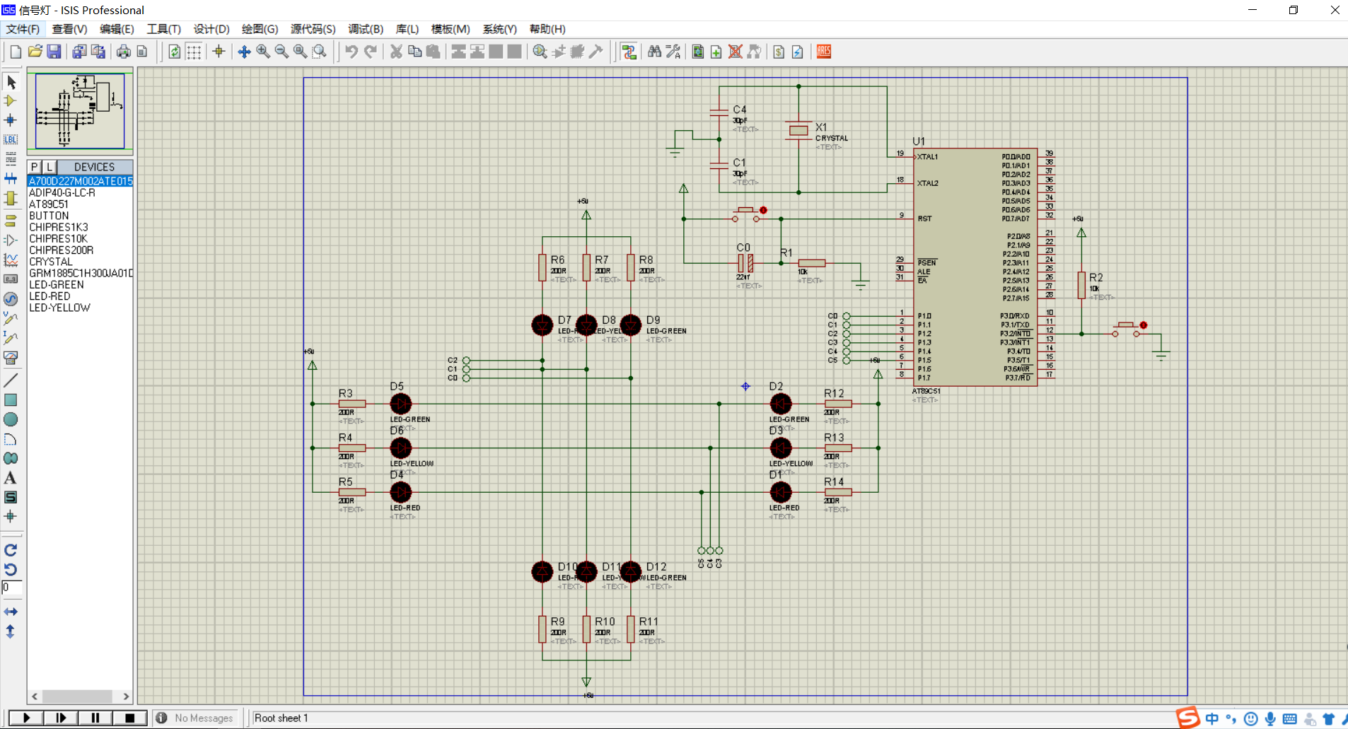

有紧急情况的交通信号灯的单片机控制系统
#include"reg51.h"
unsigned char t,t1;
void delay1s()
for(t=0;t<0x14;t++)
TH0=0x3c;
TL0=0xb0;
TR0=1;
while(! TF0);
TF0=0;
void delay_t1(unsigned char t2)
for(t1=0;t1<t2;t1++)
delay1s();
void int_0()interrupt 0
unsigned char x,y,z,m,n;
x=P1;
y=t;
z=t1;
m=TH0;
n=TL0;
P1=0xdb;
delay_t1(10);
P1=x;
t=y;
t1=z;
TH0=m;
TL0=n;
void main()
TMOD=0x01;
EA=1;
EX0=1;
IT0=1;
P1=0x33;
delay_t1(25);
P1=0x35;
delay_t1(5);
P1=0x1e;
delay_t1(25);
P1=0x2e;
delay_t1(5);
