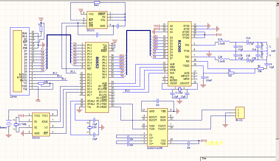

考勤机电路原理图如下:
  1. /*************************************************************************/
  2. #include <string.h>
  3. #include <m500a.h>
  4. #include <main.h>
  5. #include <reg52.h>
  6. sbit   LED  =  P2^6;
  7. sbit   WARN =  P2^7;
  8. ////////////////////////////////////////////////////////////////////
  9. void    main (void)
  10. {
  11. //  unsigned char counter;
  12.   unsigned char status1,cnt;
  13.   unsigned char Snr_RC500[4];       // Serial Number of the MFRC500
  14.   unsigned char cardserialno[4];
  15.   unsigned char cardtype[2];
  16.   P2 = 0x00;
  17.   LED = 1;WARN = 1;
  18.   init_lcd();
  19.   clrram();
  20.   timer_init();
  21.   line_disp(0,message_init[0]);
  22.   rs232_init();
  23.   RC500Config();      // Initialise the RC500
  24.   PcdReadE2(8,4,Snr_RC500); // Read out the MFRC500 serial number and store it
  25.   rs232_send(Snr_RC500,4);
  26.   line_disp(0,message_init[0]);
  27.   line_disp(1,message_init[1]);
  28.   line_disp(2,message_init[2]);
  29.   line_disp(3,message_init[3]);
  30.   delay_1s(1200);
  31.   clrram();
  32.   time_disp2();
  33.   line_disp(1,line);
  34.   line_disp(2,init_finish);
  35.   line_disp(3,line);
  36.   delay_1s(1200);
  37.   clrram();
  38.   time_disp1();
  39.   line_disp(2,line);
  40.   line_disp(3,inputcard);
  41.   LED = 0;
  42.   while(1)
  43.     {
  44.          while(CardRequest(PICC_REQALL, cardtype)==MI_OK)
  45.             {
  46.                 status1=ReadCardNum(0,cardserialno);
  47.                 if (status1 == MI_OK)
  48.                         {
  49.                         cnt = compare(card,cardserialno);
  50.                         clrram();
  51.                         if(cnt > CARD_NUM)
  52.                                 {
  53.                                 line_disp(0,error1);
  54.                                 line_disp(2,error2);
  55.                                 WARN = 0;
  56.                                 }
  57.                         else
  58.                                 {
  59.                                 line_disp(2,name[cnt]);
  60.                                 line_disp(3,welcome);
  61.                                 line_disp(1,line);
  62.                                 time_disp2();
  63.                                 LED = 1;
  64.                                 }
  65.                          rs232_send(cardserialno,4);
  66.                         }
  67.                 delay_1s(500);
  68. ……………………
  69. …………限于本文篇幅 余下代码请从51黑下载附件…………
