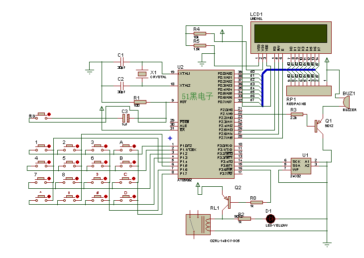

单片机密码锁项目程序带拍仿真图 1602显示
简单的密码锁项目带图
  1. //包含头文件
  2. #include <REG51.h>
  3. #include<intrins.h>
  4. //宏定义
  5. #define LCM_Data  P0                  //将P0口定义为LCM_Data
  6. #define uchar unsigned char
  7. #define uint  unsigned int
  8. //1602的控制脚
  9. sbit lcd1602_rs=P2^5;
  10. sbit lcd1602_rw=P2^6;
  11. sbit lcd1602_en=P2^7;
  12. sbit Scl=P3^4;                        //24C02串行时钟
  13. sbit Sda=P3^5;                        //24C02串行数据
  14. sbit ALAM = P2^1;                //报警
  15. sbit KEY = P3^6;                //开锁
  16. bit  pass=0;                        //密码正确标志
  17. bit  ReInputEn=0;                //重置输入允许标志
  18. bit  s3_keydown=0;                //3秒按键标志位
  19. bit  key_disable=0;                //锁定键盘标志
  20. unsigned char countt0,second;        //t0中断计数器,秒计数器
  21. void Delay5Ms(void);                //声明延时函数
  22. unsigned char code a[]={0xFE,0xFD,0xFB,0xF7};                                 //控盘扫描控制表
  23. //液晶显示数据数组
  24. unsigned char code start_line[]        = {"password:       "};
  25. unsigned char code name[]                  = {"===Coded Lock==="};        //显示名称
  26. unsigned char code Correct[]         = {"     correct    "};                //输入正确
  27. unsigned char code Error[]           = {"      error     "};          //输入错误
  28. unsigned char code codepass[]        = {"      pass      "};
  29. unsigned char code LockOpen[]        = {"      open      "};                //OPEN
  30. unsigned char code SetNew[]         = {"SetNewWordEnable"};
  31. unsigned char code Input[]           = {"input:          "};                //INPUT
  32. unsigned char code ResetOK[]         = {"ResetPasswordOK "};
  33. unsigned char code initword[]        = {"Init password..."};
  34. unsigned char code Er_try[]                = {"error,try again!"};
  35. unsigned char code again[]                = {"input again     "};
  36. unsigned char InputData[6];                                                                        //输入密码暂存区
  37. unsigned char CurrentPassword[6]={0,0,0,0,0,0};                         //读取EEPROM密码暂存数组
  38. unsigned char TempPassword[6];
  39. unsigned char N=0;                                //密码输入位数记数
  40. unsigned char ErrorCont;                        //错误次数计数
  41. unsigned char CorrectCont;                        //正确输入计数
  42. unsigned char ReInputCont;                         //重新输入计数
  43. unsigned char code initpassword[6]={0,0,0,0,0,0};                        //输入管理员密码后将密码初始为000000
  44. unsigned char code adminpassword[6]={1,3,1,4,2,0};                        //输入管理员密码后将密码初始为000000

  771. }
所有资料51hei提供下载:
密码锁.7z (468.57 KB, 下载次数: 28)
