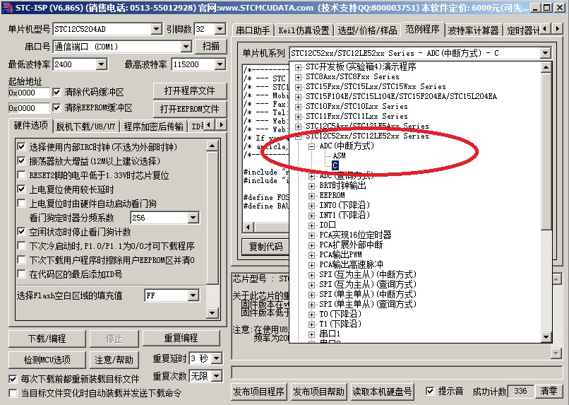

ID:213173 发表于 2019-8-16 06:28 | 只看该作者
  1. /*------------------------------------------------------------------*/
  2. /* --- STC MCU Limited ---------------------------------------------*/
  3. /* --- STC12C5Axx Series MCU A/D Conversion Demo -------------------*/
  4. /* --- Mobile: (86)13922805190 -------------------------------------*/
  5. /* --- Fax: 86-0513-55012956,55012947,55012969 ---------------------*/
  6. /* --- Tel: 86-0513-55012928,55012929,55012966----------------------*/
  7. /* --- Web: www.STCMCU.com -----------------------------------------*/
  8. /* --- Web: www.GXWMCU.com -----------------------------------------*/
  9. /* If you want to use the program or the program referenced in the  */
  10. /* article, please specify in which data and procedures from STC    */
  11. /*------------------------------------------------------------------*/
