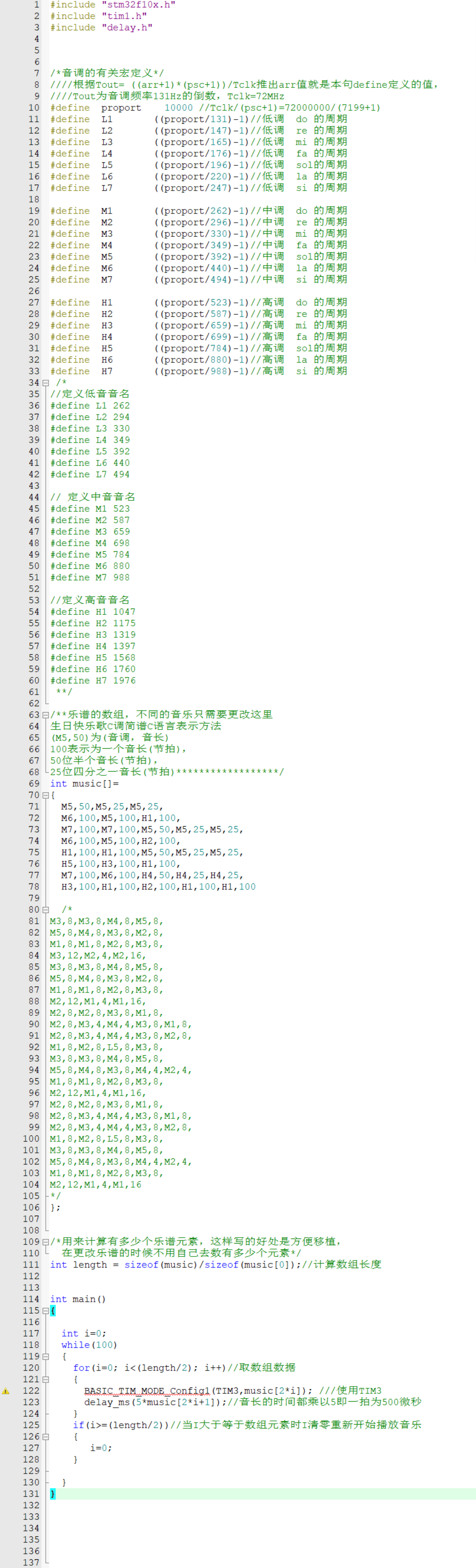

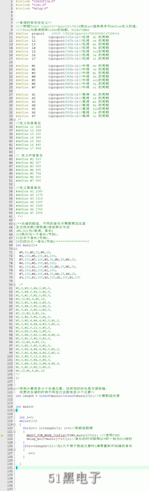

基于stm32蜂鸣器音乐播放源代码
程序源代码如下://需要详细解释看附件
#include "stm32f10x.h"
#include "tim1.h"
#include "delay.h"
#define  proport          10000 //Tclk/(psc+1)=72000000/(7199+1)
#define  L1       ((proport/131)-1)
#define  L2       ((proport/147)-1)
#define  L3       ((proport/165)-1)
#define  L4       ((proport/176)-1)
#define  L5       ((proport/196)-1)
#define  L6       ((proport/220)-1)
#define  L7       ((proport/247)-1)
#define  M1       ((proport/262)-1)
#define  M2       ((proport/296)-1)
#define  M3       ((proport/330)-1)
#define  M4       ((proport/349)-1)
#define  M5       ((proport/392)-1)
#define  M6       ((proport/440)-1)
#define  M7       ((proport/494)-1)
#define  H1       ((proport/523)-1)
#define  H2       ((proport/587)-1)
#define  H3       ((proport/659)-1)
#define  H4       ((proport/699)-1)
#define  H5       ((proport/784)-1)
#define  H6       ((proport/880)-1)
#define  H7       ((proport/988)-1)
#define L1 262
#define L2 294
#define L3 330
#define L4 349
#define L5 392
#define L6 440
#define L7 494
#define M1 523
#define M2 587
#define M3 659
#define M4 698
#define M5 784
#define M6 880
#define M7 988
#define H1 1047
#define H2 1175
#define H3 1319
#define H4 1397
#define H5 1568
#define H6 1760
#define H7 1976
int music[]=
        M5,50,M5,25,M5,25,
        M6,100,M5,100,H1,100,
        M7,100,M7,100,M5,50,M5,25,M5,25,
        M6,100,M5,100,H2,100,
        H1,100,H1,100,M5,50,M5,25,M5,25,
        H5,100,H3,100,H1,100,
        M7,100,M6,100,H4,50,H4,25,H4,25,
        H3,100,H1,100,H2,100,H1,100,H1,100
M3,8,M3,8,M4,8,M5,8,
M5,8,M4,8,M3,8,M2,8,
M1,8,M1,8,M2,8,M3,8,
M3,12,M2,4,M2,16,
M2,12,M1,4,M1,16,
M2,8,M2,8,M3,8,M1,8,
M2,8,M3,4,M4,4,M3,8,M1,8,
M2,8,M3,4,M4,4,M3,8,M2,8,
M1,8,M2,8,L5,8,M3,8,
M5,8,M4,8,M3,8,M4,4,M2,4,
M2,12,M1,4,M1,16,
M2,12,M1,4,M1,16
int length = sizeof(music)/sizeof(music[0]);
int main()
        int i=0;
  while(100)
                for(i=0; i<(length/2); i++)
                        BASIC_TIM_MODE_Config1(TIM3,music[2*i]);
                        delay_ms(5*music[2*i+1]);
                if(i>=(length/2))
                   i=0;
