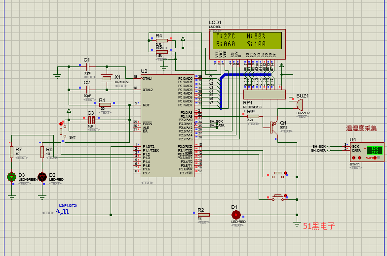

单片机户外运动监测系统Proteus仿真程序
测量温湿度和心率脉搏测量,心率脉搏可设置,超过设置值,进行声光告警
脉冲值不要太大,不要超过35
由于仿真中没有红外,手指也模拟不了,其实就是单片机的IO口检测脉冲信号,那样用个方波信号模拟就行了
  1. #include <reg52.h>
  2. #include <intrins.h>
  3. #include "LCD1602.h"
  4. #include "DHT11.h"
  5. #include "Delay.h"
  6. sbit Xintiao =P1^0 ;                                         //脉搏检测输入端定义
  7. sbit speaker =P2^1;                                                 //蜂鸣器引脚定义
  8. sbit LED_RED = P1^2;                   //红灯
  9. sbit LED_GREED = P1^3;                   //绿灯
  10. uchar xiaoting_num = 0;                  //心跳值
  11. void delay5ms(void);   //误差 0us
  12. void Tim_Init();
  13. uchar Xintiao_Change=0;           //
  14. uint  Xintiao_Jishu;
  15. uchar stop;
  16. uchar View_Change;
  17. uchar View_Data[3];
  18. uchar View_L[3];
  19. uchar View_H[3];
  20. uchar Xintiao_H=100;        //脉搏上限
  21. uchar Key_Change;
  22. uchar Key_Value;                //按键键值
  23. uchar View_Con;                        //设置的位(0正常工作,1设置上限,2设置下限)
  24. uchar View_Change;
  25. void Dispaly_Xintiao(void);
  26. void main( void )          //主函数
  27. {
  28. InitLcd();
  29. Tim_Init();
  30. ShtConnectReset();
  31. LED_RED = 0;
  32. LED_GREED = 0;
  33. TR0=1;
  34. TR1=1;                                  //打开定时器
  35. while(1)                          //进入循环
  36.   {
  37.     Display_STH11();                  //显示温湿度
  38.         Dispaly_Xintiao();                  //显示心跳值
  39.         if( Key_Value == 2 )           //心跳值设置 加
  40.         {
  41.                 Xintiao_H++;
  42.                 if( Xintiao_H >= 160 )
  43.                 {
  44.                         Xintiao_H = 160;
  45.                 }
  46.                 Key_Value = 10;
  47.         }
  48.         if( Key_Value == 3 )                 //心跳值设置 减
  49.         {
  50.                 Xintiao_H--;
  51.                 if( Xintiao_H <= 60 )
  52.                 {
  53.                         Xintiao_H = 60;
  54.                 }
  55.                 Key_Value = 10;
  56.         }
  57.         if( Xintiao_H > xiaoting_num )
  58.         {
  59.                 LED_RED = 1;
  60.                 LED_GREED = 0;
  61.         }
  62.         else
  63.         {
  64.                 LED_RED = 0;
  65.                 LED_GREED = 1;
  66.         }
  67.   }
  68. }
  69. //心跳显示
  70. void Dispaly_Xintiao( void )
  71. {
  72.   LCD_WriteCom( 0x80 + 0x40 );
  73.   LCD_WriteData( 'R' );
  74.   LCD_WriteData( ':' );
  75.   LCD_WriteData( View_Data[0] );
  76.   LCD_WriteData( View_Data[1] );
  77.   LCD_WriteData( View_Data[2] );
  78.   xiaoting_num = View_Data[0]*100 + View_Data[1]*10 + View_Data[3];
  79.   LCD_WriteData( ' ' );
  80.   LCD_WriteData( ' ' );
  81.   LCD_WriteData( ' ' );
  82.   LCD_WriteData( 'S' );
  83.   LCD_WriteData( ':' );
  84.   LCD_WriteData( Xintiao_H/100 + 0x30 );
  85.   LCD_WriteData( Xintiao_H%100/10 + 0x30 );
  86.   LCD_WriteData( Xintiao_H%10 + 0x30 );
  87.   LCD_WriteData( ' ' );
  88.   LCD_WriteData( ' ' );
  89. }
  90. void Time1() interrupt 3                //定时器1服务函数
  91. {
  92.         static uchar Key_Con,Xintiao_Con;
  93.         TH1=0xd8;                   //10ms
  94.         TL1=0xf0;                   //重新赋初值
  95.         switch(Key_Con)   //无按键按下时此值为0
  96.         {
  97.                 case 0:                   //每10ms扫描此处
  98.                 {
  99.                         if((P3&0x07)!=0x07)//扫描按键是否有按下
  100.                         {
  101.                                 Key_Con++;                  //有按下此值加1,值为1
  102.                         }
  103.                         break;
  104.                 }
  105.                 case 1:                                          //10ms后二次进入中断后扫描此处(Key_Con为1)
  106.                 {
  107.                         if((P3&0x07)!=0x07)//第二次进入中断时,按键仍然是按下(起到按键延时去抖的作用)
  108.                         {
  109.                                 Key_Con++;                  //变量加1,值为2
  110.                                 switch(P3&0x07)  //判断是哪个按键按下
  111.                                 {
  112.                                         case 0x06:Key_Value=1;break;         //判断好按键后将键值赋值给变量Key_Value
  113.                                         case 0x05:Key_Value=2;break;
  114.                                         case 0x03:Key_Value=3;break;
  115.                                 }
  116.                         }
  117.                         else                                                                 //如果10ms时没有检测到按键按下(按下时间过短)
  118.                         {
  119.                                 Key_Con=0;                                                 //变量清零,重新检测按键
  120.                         }
  121.                         break;
  122.                 }
  123.                 case 2:                                                                         //20ms后检测按键
  124.                 {
  125.                         if((P3&0x07)==0x07)                                 //检测按键是否还是按下状态
  126.                         {
  127.                                 Key_Change=1;                                         //有按键按下使能变量,(此变量为1时才会处理键值数据)
  128.                                 Key_Con=0;                                                //变量清零,等待下次有按键按下
  129.                         }
  130.                         break;
  131.                 }
  132.         }
  133.
  134.         switch (Xintiao_Con)//此处与上面按键的检测类似
  135.         {
  136.                 case 0:                         //默认Xintiao_Con是为0的
  137.                 {
  138.                         if(!Xintiao)//每10ms(上面的定时器)检测一次脉搏是否有信号
  139.                         {
  140.                                 Xintiao_Con++;//如果有信号,变量加一,程序就会往下走了
  141.                         }
  142.                         break;
  143.                 }
  144.                 case 1:
  145.                 {
  146.                         if(!Xintiao)           //每过10ms检测一下信号是否还存在
  147.                         {
  148.                                 Xintiao_Con++;//存在就加一
  149.                         }
  150.                         else
  151.                         {
  152.                                 Xintiao_Con=0;//如果不存在了,检测时间很短,说明检测到的不是脉搏信号,可能是其他干扰,将变量清零,跳出此次检测
  153.                         }
  154.                         break;
  155.                 }
  156.                 case 2:
  157.                 {
  158.                         if(!Xintiao)
  159.                         {
  160.                                 Xintiao_Con++;//存在就加一
  161.                         }
  162.                         else
  163.                         {
  164.                                 Xintiao_Con=0;//如果不存在了,检测时间很短,说明检测到的不是脉搏信号,可能是其他干扰,将变量清零,跳出此次检测
  165.                         }
  166.                         break;
  167.                 }
  168.                 case 3:
  169.                 {
  170.                         if(!Xintiao)
  171.                         {
  172.                                 Xintiao_Con++;//存在就加一
  173.                         }
  174.                         else
  175.                         {
  176.                                 Xintiao_Con=0;//如果不存在了,检测时间很短,说明检测到的不是脉搏信号,可能是其他干扰,将变量清零,跳出此次检测
  177.                         }
  178.                         break;
  179.                 }
  180.                 case 4:
  181.                 {
  182.                         if(Xintiao)//超过30ms一直有信号,判定此次是脉搏信号,执行以下程序
  183.                         {
  184.                                 if(Xintiao_Change==1)//心率计原理为检测两次脉冲间隔时间计算心率,变量Xintiao_Change第一次脉冲时为0的,所有走下面的else,第二次走这里
  185.                                 {
  186.                                         View_Data[0]=(6000/Xintiao_Jishu)/100+0x30;
  187.                                         View_Data[1]=(6000/Xintiao_Jishu)%100/10+0x30;
  188.                                         View_Data[2]=(6000/Xintiao_Jishu)%10+0x30;
  189.
  190.
  191.                                         View_Change=1;           //计算出心率后启动显示
  192.                                         Xintiao_Jishu=0;           //心跳计数清零
  193.                                         Xintiao_Change=0;   //计算出心率后该变量清零,准备下次检测心率
  194.                                         stop=0;                           //计算出心率后stop清零
  195.                                    TR0=0;
  196.                                 //   wendu=ReadTemperature();
  197.                                 //   TR1=0;
  198.                                 }
  199.                                 else//第一次脉冲时Xintiao_Change为0
  200.                                 {
  201.                                         Xintiao_Jishu=0;        //脉冲计时变量清零,开始计时
  202.                                         Xintiao_Change=1;//Xintiao_Change置1,准备第二次检测到脉冲时计算心率
  203.                                         TR0=1;
  204.                                 }
  205.                                 Xintiao_Con=0;        //清零,准备检测下一次脉冲
  206.                                 break;
  207.                         }
  208.                 }
  209.         }
  210. }
  211. /**定时器T0工作函数**/
  212. void Time0() interrupt 1
  213. {
  214. TH0=0xfc;                   //1ms
  215. TL0=0x18;                   //重新赋初值
  216. Xintiao_Jishu++;  //心跳计数加
  217. if(Xintiao_Jishu==5000)//心跳计数大于5000
  218.   {
  219.    Xintiao_Jishu=0;                //数据清零
  220.    View_Change=1;                //显示位置1
  221.    Xintiao_Change=0;        //置零,准备再次检测
  222.    stop=1;           //心跳计数超过5000后说明心率不正常或者没有测出,stop置1
  223.    speaker=1;  //关闭蜂鸣器
  224.   }
  225. }
  226. /**定时器初始化函数**/
  227. void Tim_Init()
  228. {
  229. EA=1;                          //打开中断总开关
  230. ET0=1;                          //打开T0中断允许开关
  231. ET1=1;                          //打开T1中断允许开关
  232. TMOD=0x11;                  //设定定时器状态
  233. TH0=0xfc;                   //1ms
  234. TL0=0x18;                   //赋初值
  235. TH1=0xd8;                   //10ms
  236. TL1=0xf0;                   //赋初值
  237. }

ID:792691 发表于 2020-7-8 22:03 | 只看该作者
如何设置心率脉搏啊

ID:935652 发表于 2021-6-9 21:23 来自触屏版 | 只看该作者
用Proteus8.8打开可以仿真
