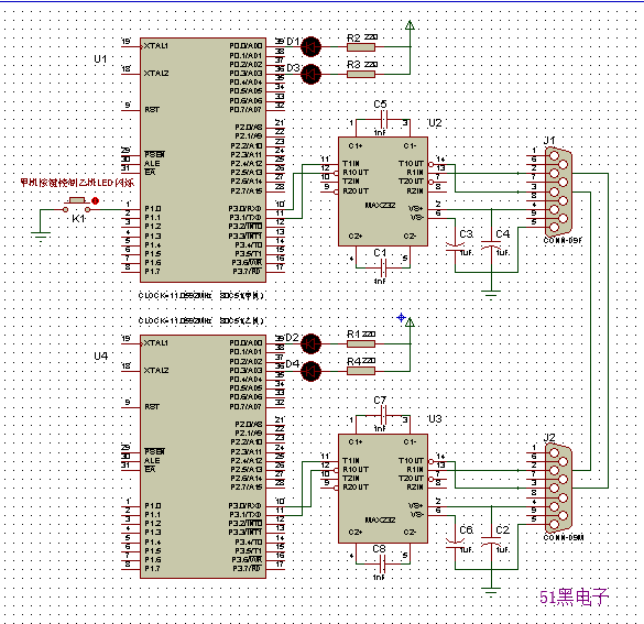

一个单片机通过串口控制另一个单片机的led灯 Proteus仿真源程序
  1. /***************   writer:shopping.w   ******************/
  2. #include <reg52.h>
  3. #define uint unsigned int
  5. sbit LED1 = P0^0;
  6. sbit LED2 = P0^3;
  7. sbit K1 = P1^0;
  8. void Delay(uint x)
  9. {
  10.         uchar i;
  11.         while(x--)
  12.         {
  13.                  for(i=0;i<120;i++);
  14.         }
  15. }
  16. void putc_to_SerialPort(uchar c)
  17. {
  18.         SBUF = c;
  19.         while(TI == 0);
  20.         TI = 0;
  21. }
  22. void main()
  23. {
  24.         uchar Operation_NO = 0;
  25.         SCON = 0x40;
  26.         TMOD = 0x20;
  27.         PCON = 0x00;
  28.         TH1 = 0xfd;
  29.         TL1 = 0xfd;
  30.         TI = 0;
  31.         TR1 = 1;
  32.         while(1)
  33.         {
  34.                  if(K1 == 0)
  35.                 {
  36.                          while(K1==0);
  37.                         Operation_NO=(Operation_NO+1)%4;
  38.                 }
  39.                 switch(Operation_NO)
  40.                 {
  41.                          case 0:
  42.                                         LED1=LED2=1; break;
  43.                         case 1:
  44.                                         putc_to_SerialPort('A');
  45.                                         LED1=~LED1;LED2=1;break;
  46.                         case 2:
  47.                                         putc_to_SerialPort('B');
  48.                                         LED2=~LED2;LED1=1;break;
  49.                         case 3:
  50.                                         putc_to_SerialPort('C');
  51.                                         LED1=~LED1;LED2=LED1;break;
  52.                 }
  53.                 Delay(10);
  54.         }
  55. }
