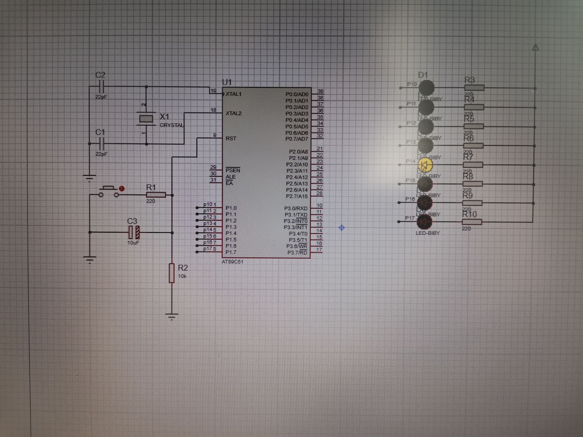

用51单片机实现的八位流水灯
电路图和具体实验程序如下
  1. #include<reg51.h>
  2. #define  uchar unsigned char
  3. uchar tab[]={0xfe,0xfd,0xfb,0xf7,0xef,0xdf,0xbf,0x7f};
  4. void delay(unsigned int i)
  5. {
  6. unsigned int m,n;
  7. for(m=i;m>0;m--)
  8.   for(n=90;n>0;n--);
  9. }
  10. void main()
  11. { uchar i;
  12. while(1)
  13. {
  14. for(i=0;i<8;i++)
  15. {P1=tab[i];
  16. delay(1000);
  17. }
  18. }
  19. }
