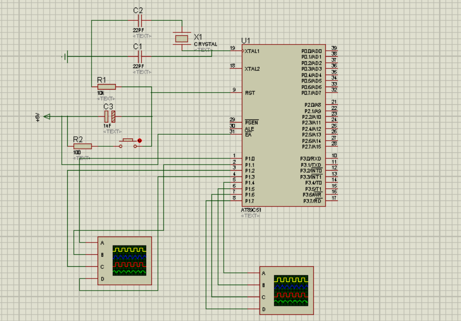

51单片机输出8路脉冲Proteus仿真+程序
#include <reg51.h>
#define unit unsigned int
#define uchar unsigned char
sbit p10=P1^0;//P1^0输出100HZ波形
sbit p11=P1^1;//P1^1输出50HZ波形
sbit p12=P1^2;//P1^2输出25HZ波形
sbit p13=P1^3;//P1^3输出20HZ波形
sbit p14=P1^4;//P1^4输出10HZ波形
sbit p15=P1^5;//P1^5输出5HZ波形
sbit p16=P1^6;//P1^6输出2HZ波形
sbit p17=P1^7;//P1^7输出1HZ波形
uchar count0;//计数
uchar count1;
uchar count2;
uchar count3;
uchar count4;
uchar count5;
uchar count6;
uchar count7;
void main()
        count0=1;
        count1=2;
        count2=4;
        count3=5;
        count4=10;
        count5=20;
        count6=50;
        count7=100;
        TMOD=0X01;//定时器0 方式1
        TH0=(65536-5000)/256;//5000个机器周期  5ms
        TL0=(65536-5000)%256;
        EA=1;
        ET0=1;
        TR0=1;
                if(count0==0){count0=1;p10=!p10;}
                if(count1==0){count1=2;p11=!p11;}
                if(count2==0){count2=4;p12=!p12;}
                if(count3==0){count3=5;p13=!p13;}
                if(count4==0){count4=10;p14=!p14;}
                if(count5==0){count5=20;p15=!p15;}
                if(count6==0){count6=50;p16=!p16;}
                if(count7==0){count7=100;p17=!p17;}
void counter()interrupt 1
         TH0=(65536-4994)/256;
        TL0=(65536-4994)%256;
        count0--;
        count1--;
        count2--;
        count3--;
        count4--;
        count5--;
        count6--;
        count7--;
