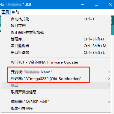

小白arduino 验证没错 上传失败 请问大佬们知道为什么吗
Arduino:1.8.9 (Windows 7), 开发板:"Arduino Nano, ATmega328P"
项目使用了 3230 字节,占用了 (10%) 程序存储空间。最大为 30720 字节。
全局变量使用了68字节,(3%)的动态内存,余留1980字节局部变量。最大为2048字节。
avrdude: stk500_recv(): programmer is not responding
avrdude: stk500_getsync() attempt 1 of 10: not in sync: resp=0xd7
avrdude: stk500_getsync() attempt 2 of 10: not in sync: resp=0xd7
avrdude: stk500_getsync() attempt 3 of 10: not in sync: resp=0xd7
avrdude: stk500_getsync() attempt 4 of 10: not in sync: resp=0xd7
avrdude: stk500_getsync() attempt 5 of 10: not in sync: resp=0xd7
avrdude: stk500_getsync() attempt 6 of 10: not in sync: resp=0xd7
avrdude: stk500_getsync() attempt 7 of 10: not in sync: resp=0xd7
avrdude: stk500_getsync() attempt 8 of 10: not in sync: resp=0xd7
avrdude: stk500_getsync() attempt 9 of 10: not in sync: resp=0xd7
avrdude: stk500_getsync() attempt 10 of 10: not in sync: resp=0xd7
上传出错。查看http://www.arduino.cc/en/Guide/Troubleshooting#upload 获取建议。
在文件 -> 首选项开启
“编译过程中显示详细输出”选项
这份报告会包含更多信息。

Arduino Nano 这个开发板,要排除硬件上的问题,可以看IDE右下角com口和板子型号是否对应,然后就是NANO这个板子用Arduino1.8以上版本要选择好处理器版本
