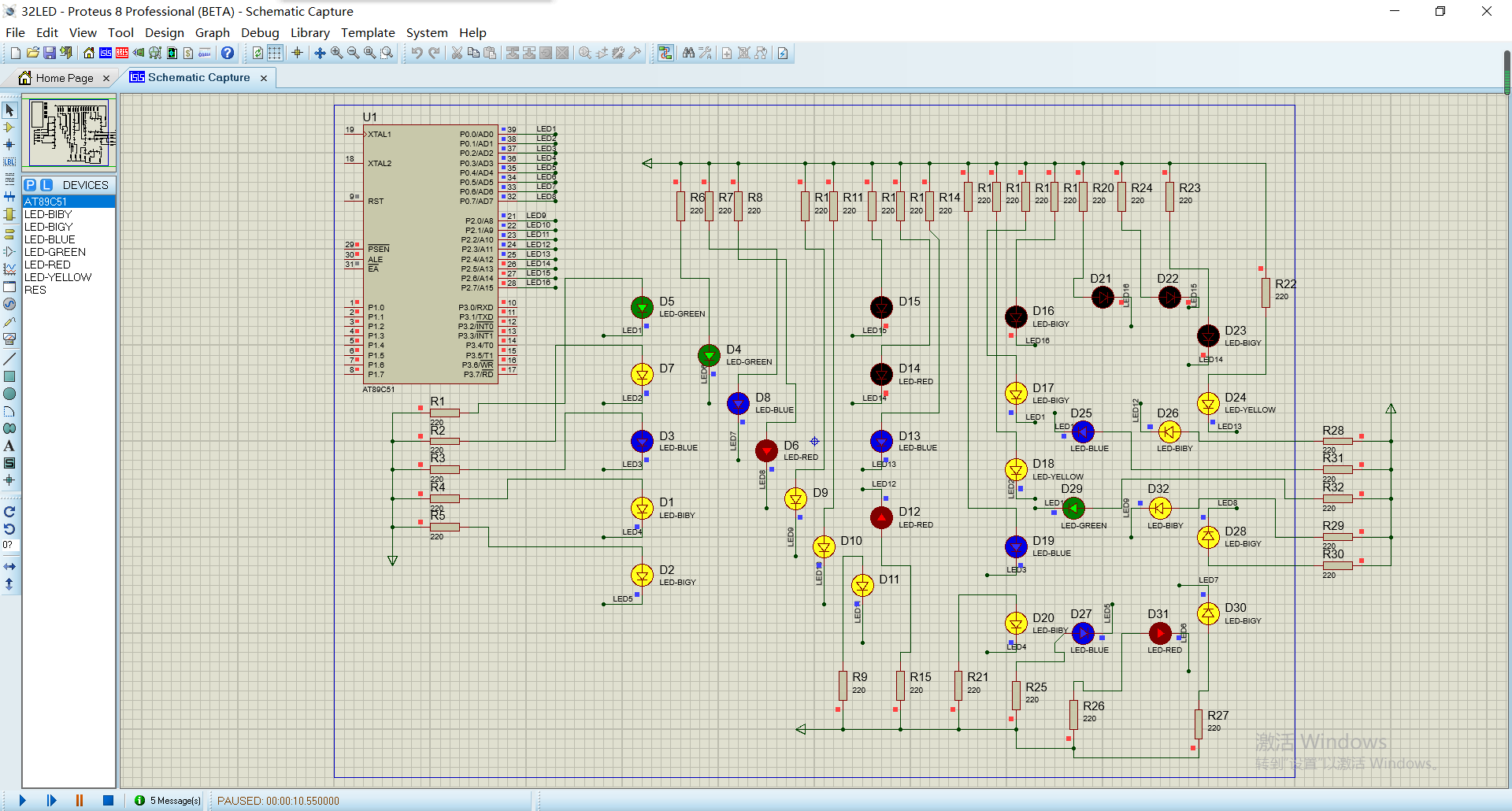

基于51单片机的32位流水灯设计 Proteus仿真程序
led灯的位置可以随意变动,这图案只是自己的一点小恶趣味
  1. #include<reg51.h>
  3. #define uint unsigned int
  4. uchar code Pattern_P0[]=
  5. {
  6. 0xfc,0xf9,0xf3,0xe7,0xcf,0x9f,0x3f,0x7f,0xff,0xff,0xff,0xff,0xff,0xff,0xff,0xff,
  7. 0xe7,0xdb,0xbd,0x7e,0xbd,0xdb,0xe7,0xff,0xe7,0xc3,0x81,0x00,0x81,0xc3,0xe7,0xff,
  8. 0xaa,0x55,0x18,0xff,0xf0,0x0f,0x00,0xff,0xf8,0xf1,0xe3,0xc7,0x8f,0x1f,0x3f,0x7f,
  9. 0x7f,0x3f,0x1f,0x8f,0xc7,0xe3,0xf1,0xf8,0xff,0x00,0x00,0xff,0xff,0x0f,0xf0,0xff,
  10. 0xfe,0xfd,0xfb,0xf7,0xef,0xdf,0xbf,0x7f,0xff,0xff,0xff,0xff,0xff,0xff,0xff,0xff,
  11. 0xff,0xff,0xff,0xff,0xff,0xff,0xff,0xff,0x7f,0xbf,0xdf,0xef,0xf7,0xfb,0xfd,0xfe,
  12. 0xfe,0xfc,0xf8,0xf0,0xe0,0xc0,0x80,0x00,0x00,0x00,0x00,0x00,0x00,0x00,0x00,0x00,
  13. 0x00,0x00,0x00,0x00,0x00,0x00,0x00,0x00,0x00,0x80,0xc0,0xe0,0xf0,0xf8,0xfc,0xfe,
  14. 0x00,0xff,0x00,0xff,0x00,0xff,0x00,0xff
  15. };
  16. uchar code Pattern_P2[]=
  17. {
  18. 0xff,0xff,0xff,0xff,0xff,0xff,0xff,0xfe,0xfc,0xf9,0xf3,0xe7,0xcf,0x9f,0x3f,0xff,
  19. 0xe7,0xdb,0xbd,0x7e,0xbd,0xdb,0xe7,0xff,0xe7,0xc3,0x81,0x00,0x81,0xc3,0xe7,0xff,
  20. 0xaa,0x55,0x18,0xff,0xf0,0x0f,0x00,0xff,0xf8,0xf1,0xe3,0xc7,0x8f,0x1f,0x3f,0x7f,
  21. 0x7f,0x3f,0x1f,0x8f,0xc7,0xe3,0xf1,0xf8,0xff,0x00,0x00,0xff,0xff,0x0f,0xf0,0xff,
  22. 0xff,0xff,0xff,0xff,0xff,0xff,0xff,0xff,0xfe,0xfd,0xfb,0xf7,0xef,0xdf,0xbf,0x7f,
  23. 0x7f,0xbf,0xdf,0xef,0xf7,0xfb,0xfd,0xfe,0xff,0xff,0xff,0xff,0xff,0xff,0xff,0xff,
  24. 0xff,0xff,0xff,0xff,0xff,0xff,0xff,0xff,0xfe,0xfc,0xf8,0xf0,0xe0,0xc0,0x80,0x00,
  25. 0x00,0x80,0xc0,0xe0,0xf0,0xf8,0xfc,0xfe,0xff,0xff,0xff,0xff,0xff,0xff,0xff,0xff,
  26. 0x00,0xff,0x00,0xff,0x00,0xff,0x00,0xff
  27. };
  28. //延时
  29. void DelayMS(uint x)
  30. {
  31. uchar i;
  32. while(x--)
  33. {
  34. for(i=0;i<120;i++);
  35. }
  36. }
  37. //主程序
  38. void main()
  39. {
  40. uchar i;
  41. while(1)
  42. { //从数组中读取数据送至 P0 和 P2 口显示
  43. for(i=0;i<136;i++)
  44. {
  45. P0=Pattern_P0[i];
  46. P2=Pattern_P2[i];
  47. DelayMS(100);
  48. }
  49. }
  50. }
