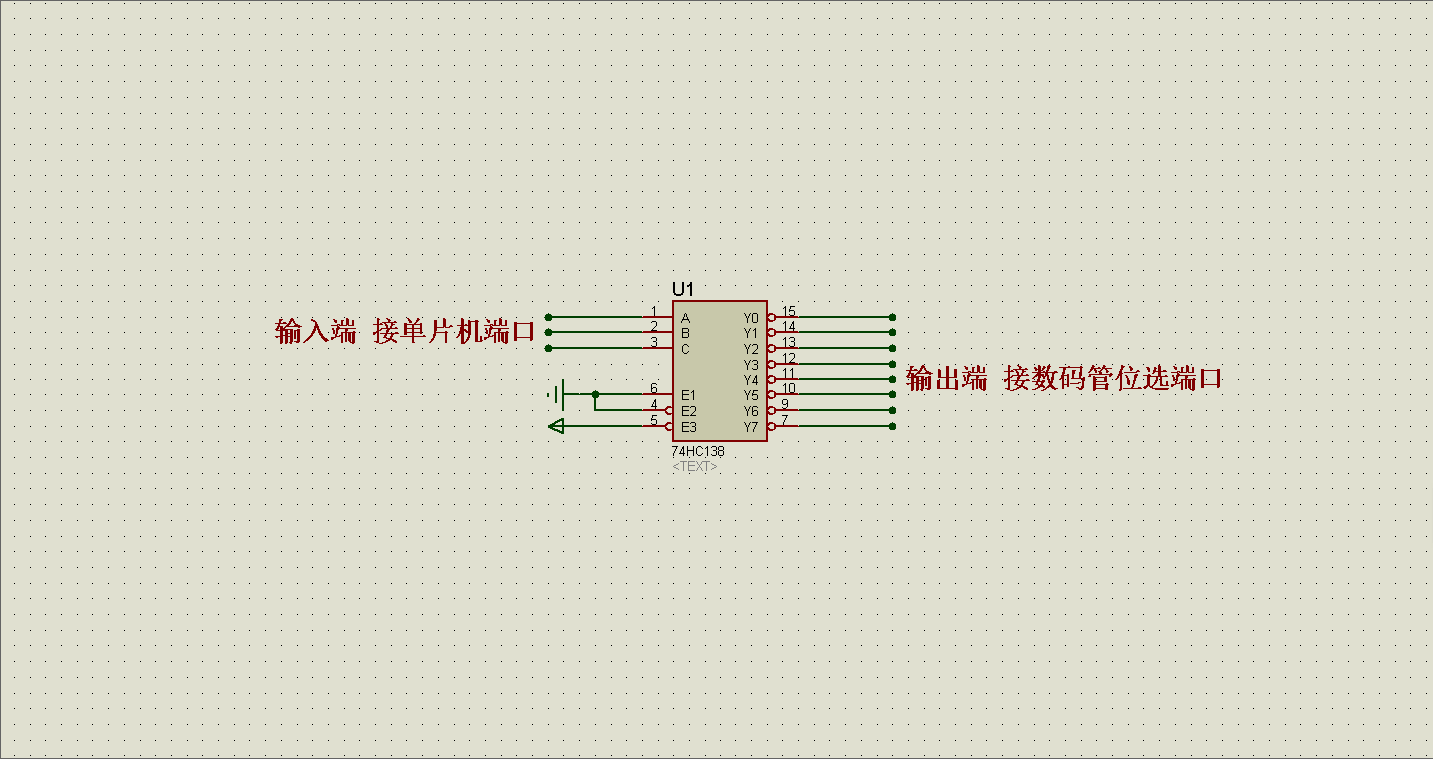

  9. sbit HCA = P2^2;//HCA,HCB,HCC是利用了74HC138译码器来进行位选,我们动态位选了4位
  10. sbit HCB = P2^3;
  11. sbit HCC = P2^4;

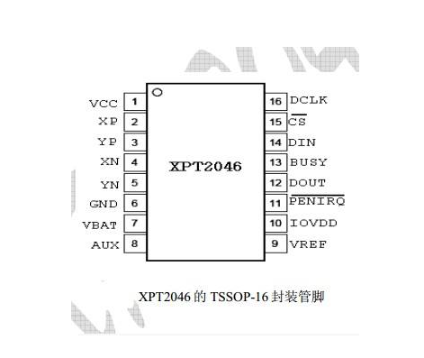

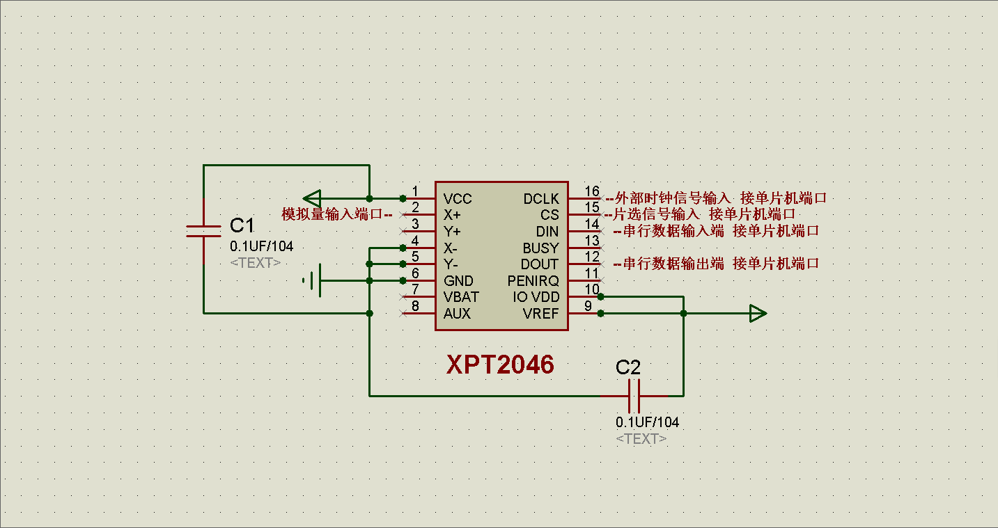

  12. sbit CLK  = P1^0;
  13. sbit CS   = P1^1;
  14. sbit DIN  = P1^2;
  15. sbit DOUT = P1^3;
