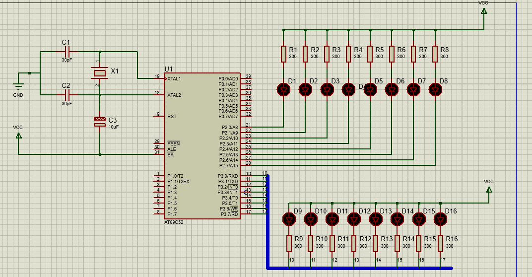

基于51单片机的广告灯程序
  1. #include <REG52.H>                                  //头文件
  2. /******定义广告灯样式******/
  3. unsigned char code table1[]={0xfe,0xfd,0xfb,0xf7,0xef,0xdf,0xbf,0x7f,0xfe,0xfd,0xfb,0xf7,0xef,
  4.                              0xdf,0xbf,0x7f,0x7f,0xbf,0xdf,0xef,0xf7,0xfb,0xfd,0xfe,0x7f,0xbf,
  5.                                                          0xdf,0xef,0xf7,0xfb,0xfd,0xfe,0x00,0xff,0x00,0xff};
  6. unsigned char code table2[]={0xff,0xfe,0xfc,0xf8,0xf0,0xe0,0xc0,0x80,0x00,0x80,0xc0,0xe0,0xf0,
  7.                              0xf8,0xfc,0xfe,0xff,0xfe,0xfc,0xf9,0xf3,0xf7,0xcf,0x9f,0x3f,0x9f,
  8.                                                          0xcf,0xf7,0xf3,0xf9,0xfc,0xff,0x7e,0x3c,0x18,0x00,0xff,0x7e,0x3c,
  9.                                                          0x18,0x00,0xff,0x7e,0x3c,0x18,0x00,0xff};
  10. //table2[]是增加的广告样式
  11. //全亮由左向右依次亮起,由右向左依次熄灭,两相邻灯同时左移右移,左右依次向中间亮起(三遍)
  12. unsigned char i;        //定义循环变量
  13. /******定义延时子函数******/
  14. void delay(void)
  15. {
  16.         unsigned char m,n,s;
  17.         for(m=20;m>0;m--)
  18.         for(n=20;n>0;n--)
  19.         for(s=248;s>0;s--);
  20. }
  21. void main(void)                                //主函数
  22. {
  23.     while(1)
  24.         {
  25.         for(i=0;i<38;i++)                //两排灯同时进行原来的广告样式
  26.         {
  27.             P2=table1[i];
  28.                 P3=table1[i];
  29.                 delay();
  30.         }
  31.         for(i=0;i<47;i++)           //两排灯同时进行新添加的广告样式
  32.         {
  33.             P2=table2[i];
  34.                 P3=table2[i];
  35.                 delay();
  36.         }
  37.         }
  38. }
  39.
