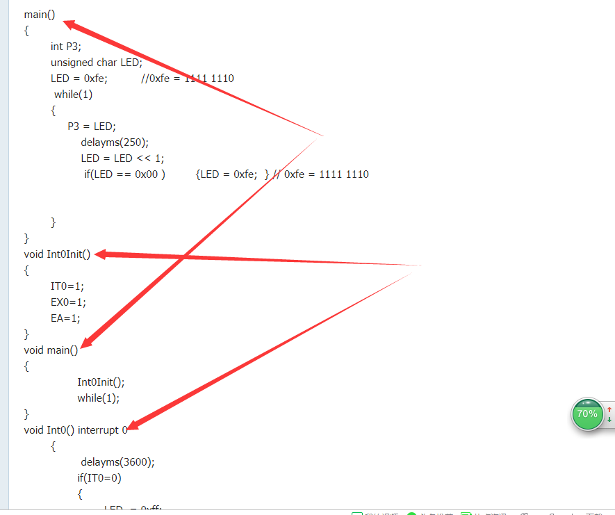

新手,不知道错在哪里?error C202: 'IT0': undefined identifier
#ifndef __STC8F_H_
#define __STC8F_H_
#include <stdio.h>
void delayms(unsigned char ms)
        unsigned char i;
        while(ms--)
                for(i = 0; i < 120; i++);
main()
        int P3;
        unsigned char LED;
        LED = 0xfe;          //0xfe = 1111 1110
             P3 = LED;
                 delayms(250);
                 LED = LED << 1;
                  if(LED == 0x00 )         {LED = 0xfe;  } // 0xfe = 1111 1110
void Int0Init()
        IT0=1;
        EX0=1;
        EA=1;
void main()
                Int0Init();
                while(1);
void Int0() interrupt 0
                 delayms(3600);
                if(IT0=0)
                        LED  = 0xff;
Rebuild target 'Target 1'
assembling STARTUP.A51...
compiling ledshuo.c...
ledshuo.c(34): error C202: 'IT0': undefined identifier
ledshuo.c(35): error C202: 'EX0': undefined identifier
ledshuo.c(36): error C202: 'EA': undefined identifier
ledshuo.c(39): error C231: 'main': redefinition
ledshuo.c(42): error C231: 'main': redefinition
ledshuo.c(46): error C202: 'IT0': undefined identifier
ledshuo.c(48): error C202: 'LED': undefined identifier
ledshuo.c(55): warning C316: unterminated conditionals
Target not created.
Build Time Elapsed:  00:00:02
请高手们指点一二,谢谢
几个标识未定义,加#include “REG51.h”,就有定义了
两main重复定义。

谢谢大神的指点,因为我用的单片机是STC15F104W 它的使用说明里,说不用另外包含REG51.H。所以没有写上去。
现在加上去了,是不是中断的程序都要51的头文件?
