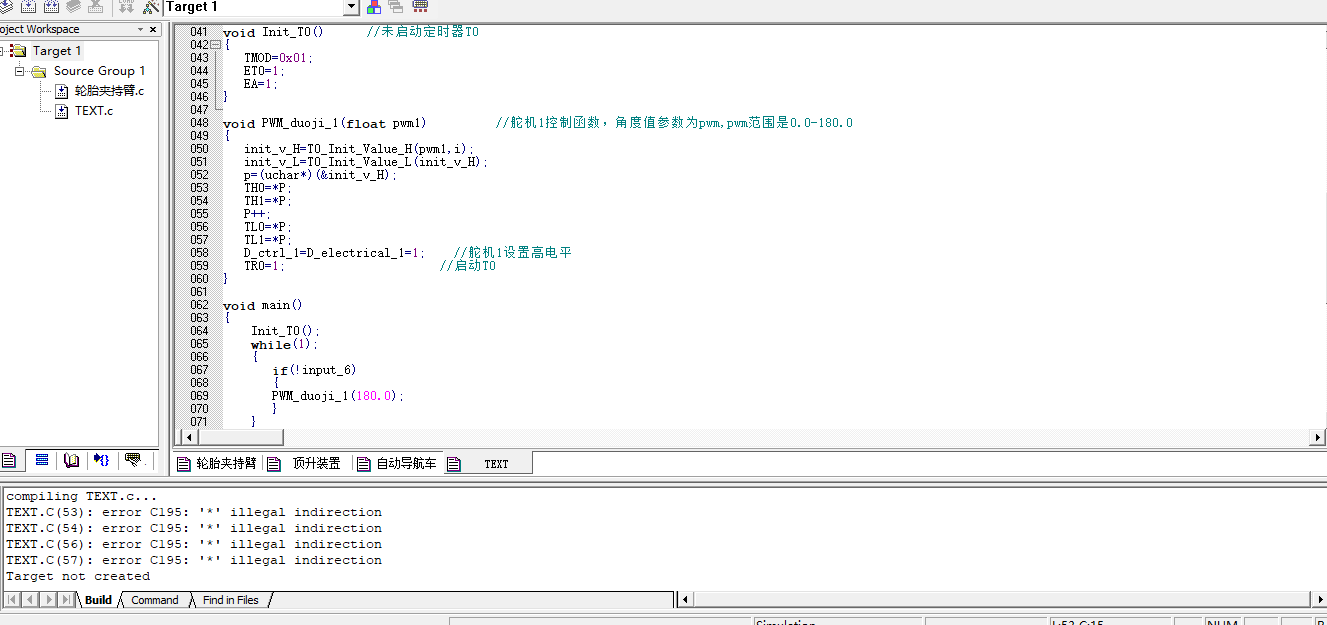

单片机舵机控制程序错误,初学者求大佬指教
#include<reg52.h>
#define uchar unsigned char
#define uint unsigned int
bit D_electrical_1;
sbit D_ctrl_1=P0^0;
sbit input_6=P2^6;
uint init_v_H;
uint init_v_L;
uint init_v;
uchar *p;
uchar TH,TL;
#define i 1950.0/180.0
void delay(uint x)
    uint y;
while(x--)
      for(y=112;y>0;y--);
uint T0_Init_Value_H(float degree,float us_per_degree)
    uint width=(unsigned int)(degree*us_per_degree);
uint init_v_H=65536-width;
return init_v_H;
uint T0_Init_Value_L(uint init_v_H)
    unsigned int init_v_L=65536-init_v_H+45536;
return init_v_L;
void Init_T0()
   TMOD=0x01;
   ET0=1;
   EA=1;
void PWM_duoji_1(float pwm1)
   init_v_H=T0_Init_Value_H(pwm1,i);
   init_v_L=T0_Init_Value_L(init_v_H);
   p=(uchar*)(&init_v_H);
   TH0=*P;
   TH1=*P;
   P++;
   TL0=*P;
   TL1=*P;
   D_ctrl_1=D_electrical_1=1;
   TR0=1;
void main()
   Init_T0();
while(1);
    if(!input_6)
    PWM_duoji_1(180.0);
void T0_Server_1() interrupt 1
   D_electrical_1=!D_electrical_1;
   if(D_electrical_1)
       init_v=init_v_H;
   else
       init_v=init_v_L;
   p=(uchar*)(&init_v);
   TH=*p;
   p++;
   TL=*p;
   D_ctrl_1=D_electrical_1;
   TH0=TH;
   TL0=TL;
