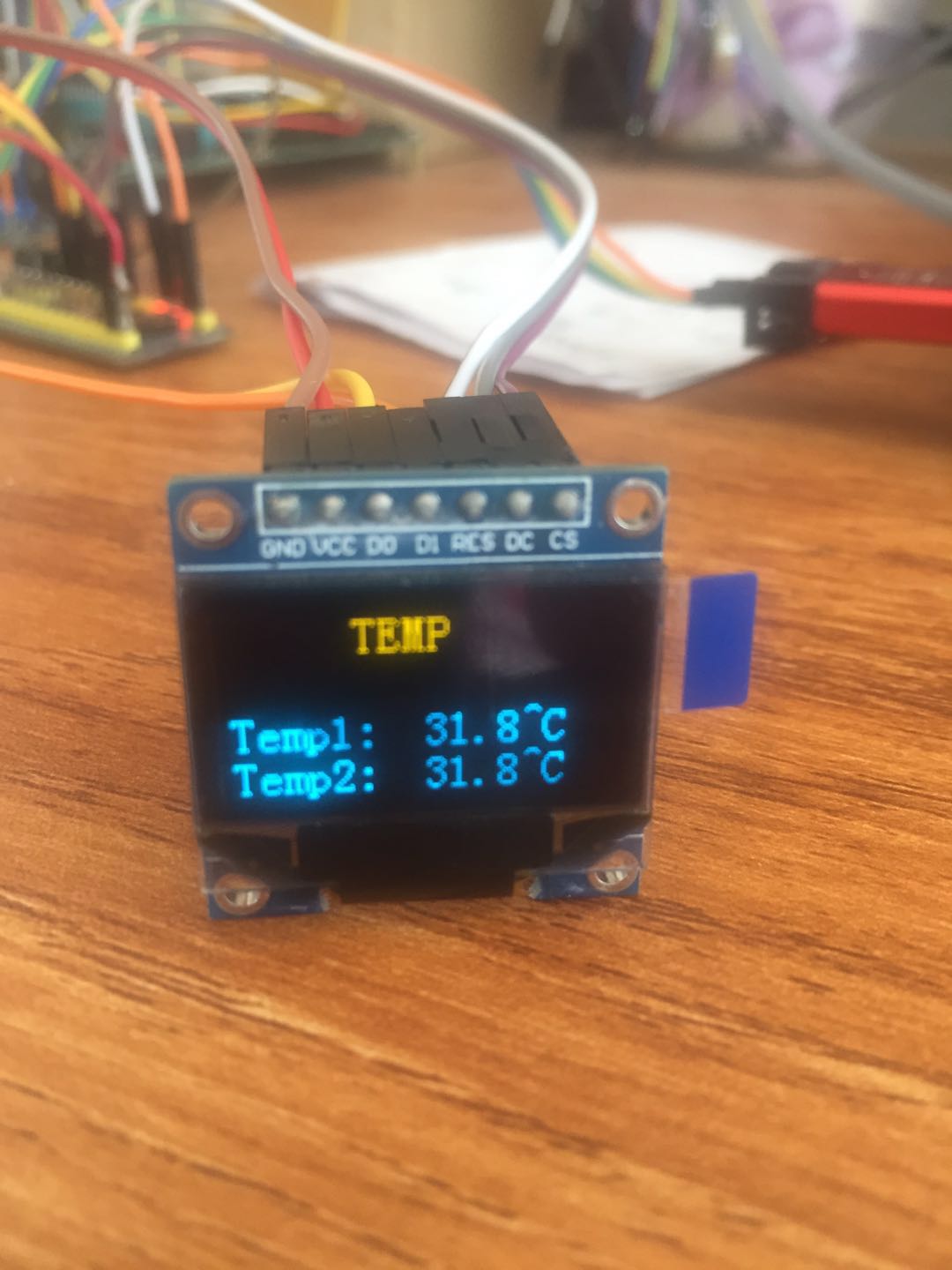

stm32多点测温oled显示程序
程序是本人移植的
需要就去下载吧

  57.     DS18B20_Init();         //PC13
  58.         uart_init(9600);
  59.         KEY_Init();//按键初始化PA2 PA4
  60.         TIM2_Init();//电机运动PWM定时器
  61. //         OLED_ShowString(0,0, "");
  62.         OLED_ShowString(0,0,"     TEMP");
  63.         OLED_ShowString(0,32,"Temp1:");
  64.         OLED_ShowString(0,48,"Temp2:");
  65. //        OLED_ShowString(0,54,"TEMP");
  66.         OLED_Refresh_Gram();

  114.                     if( speed_count >= 500)
  115.                                         {
  116.                                                  speed_count = 0;
  117.
  118.
  119.                  temperature=DS18B20_Get_Temp();
  120.                         temp=(int)temperature;
  121.
  122.                                 a=temp/100;
  123.                                         b=(temp/10)%10;
  124.                                         c=temp%10;
  125.                                         OLED_ShowNum(63,32,a,1,16);
  126.                                       OLED_ShowNum(71,32,b,1,16);
  127.                                    OLED_ShowChar(79,32,'.',16,1);
  128.                                    OLED_ShowNum(87,32,c,1,16);
  129.                                    OLED_ShowChar(95,32,'^',16,1);
  130.                                    OLED_ShowChar(103,32,'C',16,1);
  131.
  132.
  133.                                                 OLED_ShowNum(63,48,a,1,16);
  134.                                       OLED_ShowNum(71,48,b,1,16);
  135.                                    OLED_ShowChar(79,48,'.',16,1);
  136.                                    OLED_ShowNum(87,48,c,1,16);
  137.                                    OLED_ShowChar(95,48,'^',16,1);
  138.                                    OLED_ShowChar(103,48,'C',16,1);
  139.
  140.
  141.                                    OLED_Refresh_Gram();
  142.                                printf("temperature=%.2f  \n",temperature/10);
  143.
  144.                 }
  145.          }
  146. }
