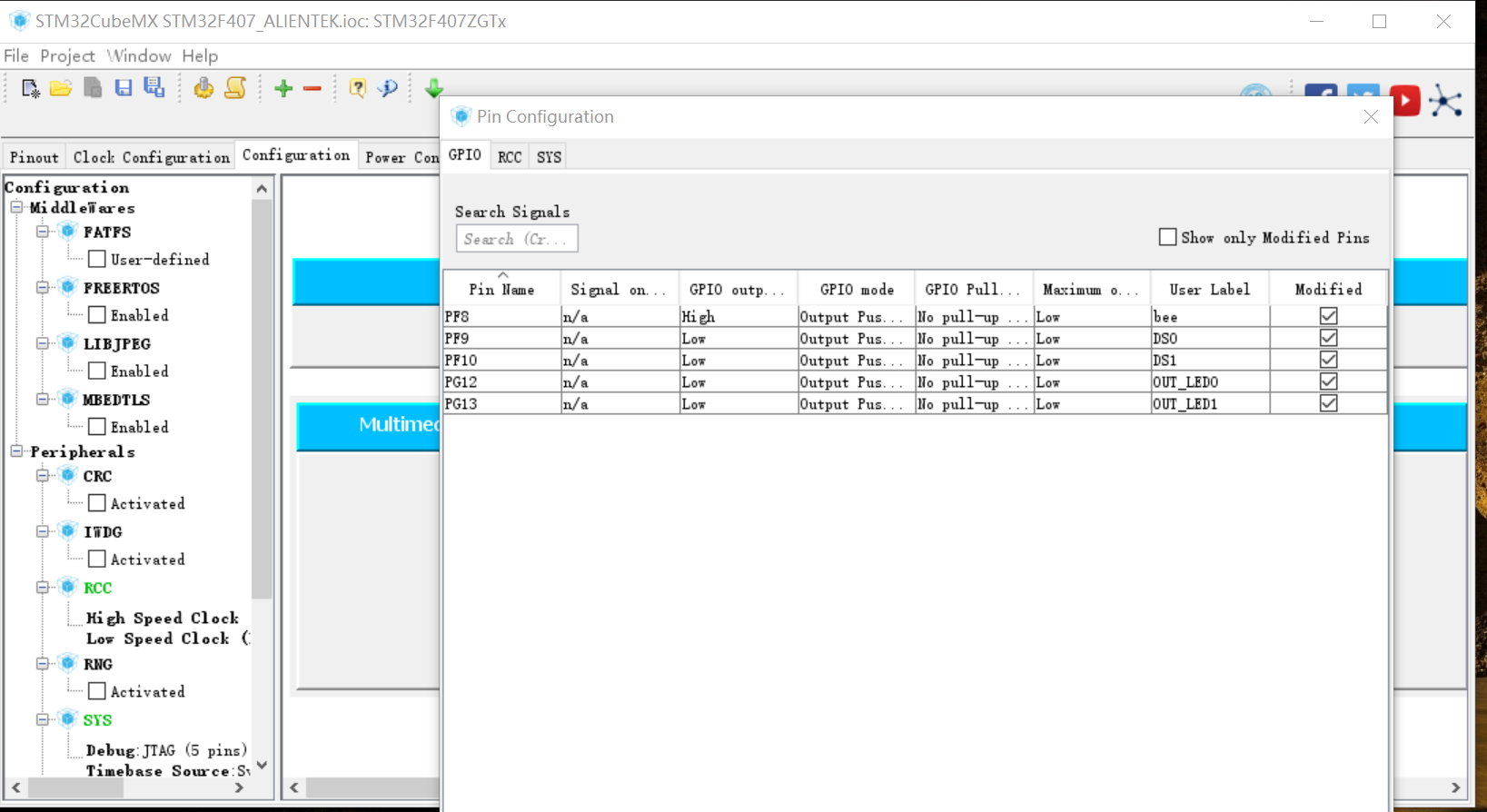

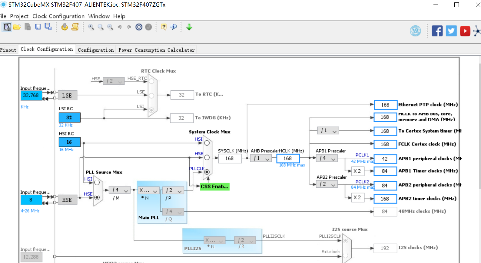

在Cube中配置正点原子的DS0 、DS1和蜂鸣器的脚位,配置如附件所示,配置自行开发的程序指示灯,这样,无论是在正点原子的开发板,还是在自行开发的嵌入式主板中,都能够观察到正常的程序运行指示灯的闪烁和蜂鸣器的定时鸣叫。其中时钟配置如附件所示截图,GPIO的配置如附件截图所示,在这个4.23.0版本的Cube程序运行正常, 没有BUG。

  38.   {
  39.   /* USER CODE END WHILE */
  40.   /* USER CODE BEGIN 3 */
  41.                         HAL_Delay(500);
  42.   /* yangji */
  43.                                 HAL_GPIO_TogglePin(GPIOG,GPIO_PIN_12);//led out
  44. //                                HAL_GPIO_TogglePin(GPIOG,GPIO_PIN_13);//BEEP
  45.         /* kaifaban */
  46.       HAL_GPIO_TogglePin(GPIOF,GPIO_PIN_8);//bee
  47.                         HAL_GPIO_TogglePin(GPIOF,GPIO_PIN_9);//DS0
  48.             HAL_GPIO_TogglePin(GPIOF,GPIO_PIN_10);//DS1

  61.   __HAL_PWR_VOLTAGESCALING_CONFIG(PWR_REGULATOR_VOLTAGE_SCALE1);
  62.     /**Initializes the CPU, AHB and APB busses clocks
  63.     */
  64.   RCC_OscInitStruct.OscillatorType = RCC_OSCILLATORTYPE_HSE;
  65.   RCC_OscInitStruct.HSEState = RCC_HSE_ON;
  66.   RCC_OscInitStruct.PLL.PLLState = RCC_PLL_ON;
  67.   RCC_OscInitStruct.PLL.PLLSource = RCC_PLLSOURCE_HSE;
  68.   RCC_OscInitStruct.PLL.PLLM = 4;
  69.   RCC_OscInitStruct.PLL.PLLN = 168;
  70.   RCC_OscInitStruct.PLL.PLLP = RCC_PLLP_DIV2;
  71.   RCC_OscInitStruct.PLL.PLLQ = 4;
  72.   if (HAL_RCC_OscConfig(&RCC_OscInitStruct) != HAL_OK)
  73.   {
  74.     _Error_Handler(__FILE__, __LINE__);
  75.   }
  76.     /**Initializes the CPU, AHB and APB busses clocks
  77.     */
  78.   RCC_ClkInitStruct.ClockType = RCC_CLOCKTYPE_HCLK|RCC_CLOCKTYPE_SYSCLK
  79.                               |RCC_CLOCKTYPE_PCLK1|RCC_CLOCKTYPE_PCLK2;
  80.   RCC_ClkInitStruct.SYSCLKSource = RCC_SYSCLKSOURCE_PLLCLK;
  81.   RCC_ClkInitStruct.AHBCLKDivider = RCC_SYSCLK_DIV1;
  82.   RCC_ClkInitStruct.APB1CLKDivider = RCC_HCLK_DIV4;
  83.   RCC_ClkInitStruct.APB2CLKDivider = RCC_HCLK_DIV2;
  84.   if (HAL_RCC_ClockConfig(&RCC_ClkInitStruct, FLASH_LATENCY_5) != HAL_OK)
