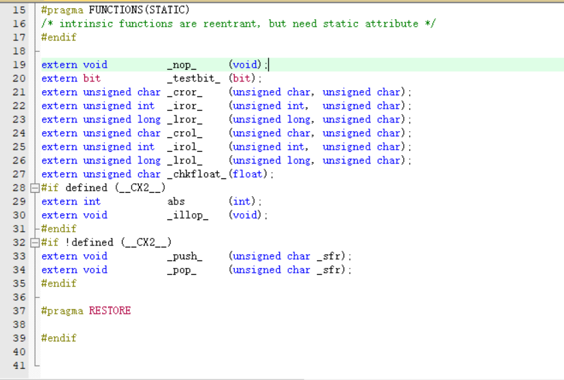

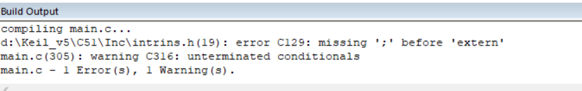

keilc51自带的intrins.h函数编译报错

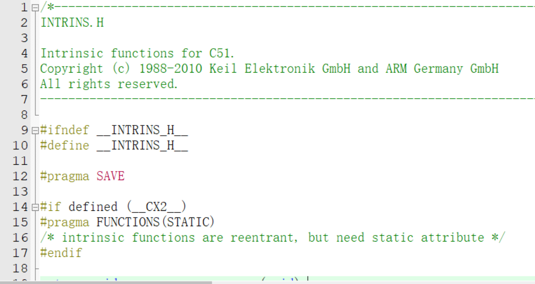

INTRINS.H
Intrinsic functions for C51.
Copyright (c) 1988-2010 Keil Elektronik GmbH and ARM Germany GmbH
All rights reserved.
#ifndef __INTRINS_H__
#define __INTRINS_H__
#pragma SAVE
#if defined (__CX2__)
#pragma FUNCTIONS(STATIC)
/* intrinsic functions are reentrant, but need static attribute */
#endif
extern void          _nop_     (void);
extern bit           _testbit_ (bit);
extern unsigned char _cror_    (unsigned char, unsigned char);
extern unsigned int  _iror_    (unsigned int,  unsigned char);
extern unsigned long _lror_    (unsigned long, unsigned char);
extern unsigned char _crol_    (unsigned char, unsigned char);
extern unsigned int  _irol_    (unsigned int,  unsigned char);
extern unsigned long _lrol_    (unsigned long, unsigned char);
extern unsigned char _chkfloat_(float);
extern int           abs       (int);
extern void          _illop_   (void);
#endif
#if !defined (__CX2__)
extern void          _push_    (unsigned char _sfr);
extern void          _pop_     (unsigned char _sfr);
#endif
#pragma RESTORE
#endif

就算是自带函数报错,错误也是在你编写的函数中找,因为自带函数不可能出错。
你这个错误是意思是少了;你看哪里缺了分号
ID:589491 发表于 2021-3-22 17:18 | 只看该作者
错误的分号
