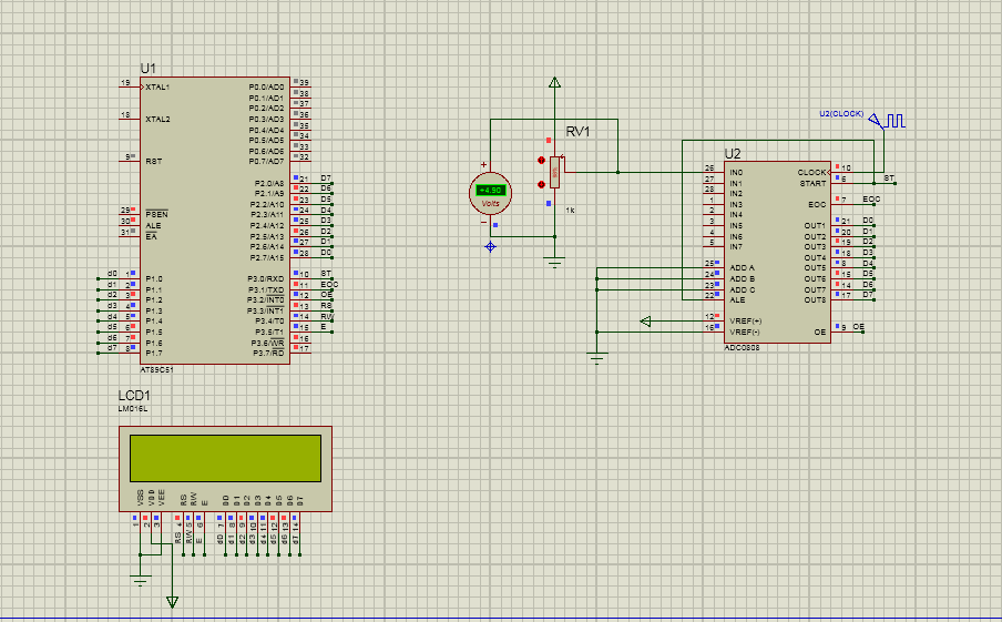

protues仿真adc0808+lcd1602没显示,求大佬看下什么问题
#include"reg51.h"
sbit start=P3^0;
sbit eoc=P3^1;
sbit oe=P3^2;
sbit RS=P3^3;
sbit RW=P3^4;
sbit E=P3^5;
unsigned char vol=0;
unsigned char t[]={"0123456789"};
unsigned char str[]={"Hello world!"};
void delay(unsigned int n)
        unsigned int i=0,j=0;
        for(i=0;i<n;i++)
        for(j=0;j<120;j++);
void adc()
        start=0;
        start=1;
        delay(5);
        start=0;
        while(eoc!=1);
        oe=1;
        vol=P2;
        oe=0;
void writedat(unsigned char dat)
RS=1;
RW=0;
E=0;
P1=dat;
delay(5);
E=1;
E=0;
void writecom(unsigned char com)
RS=0;
RW=0;
E=0;
P1=com;
delay(5);
E=1;
E=0;
void initlcd()
writecom(0x38);
writecom(0x0c);
writecom(0x06);
writecom(0x01);
void display()
unsigned char temp0=0,temp1=0,temp2=0;
temp0=vol/100;
temp1=(vol%100)/10;
temp2=vol%10;
writecom(0x80);
delay(5);
writedat(t[temp0]);
delay(5);
writedat(t[temp1]);
delay(5);
writedat(t[temp2]);
delay(5);
//void display()
//unsigned int i=0;
//writecom(0x80);
//delay(5);
//while(str[i]!='\0')
//writedat(str[i]);
//delay(5);
//i++;
void main ()
        initlcd();
        adc();
        delay(5);
        display();
        delay(5);
