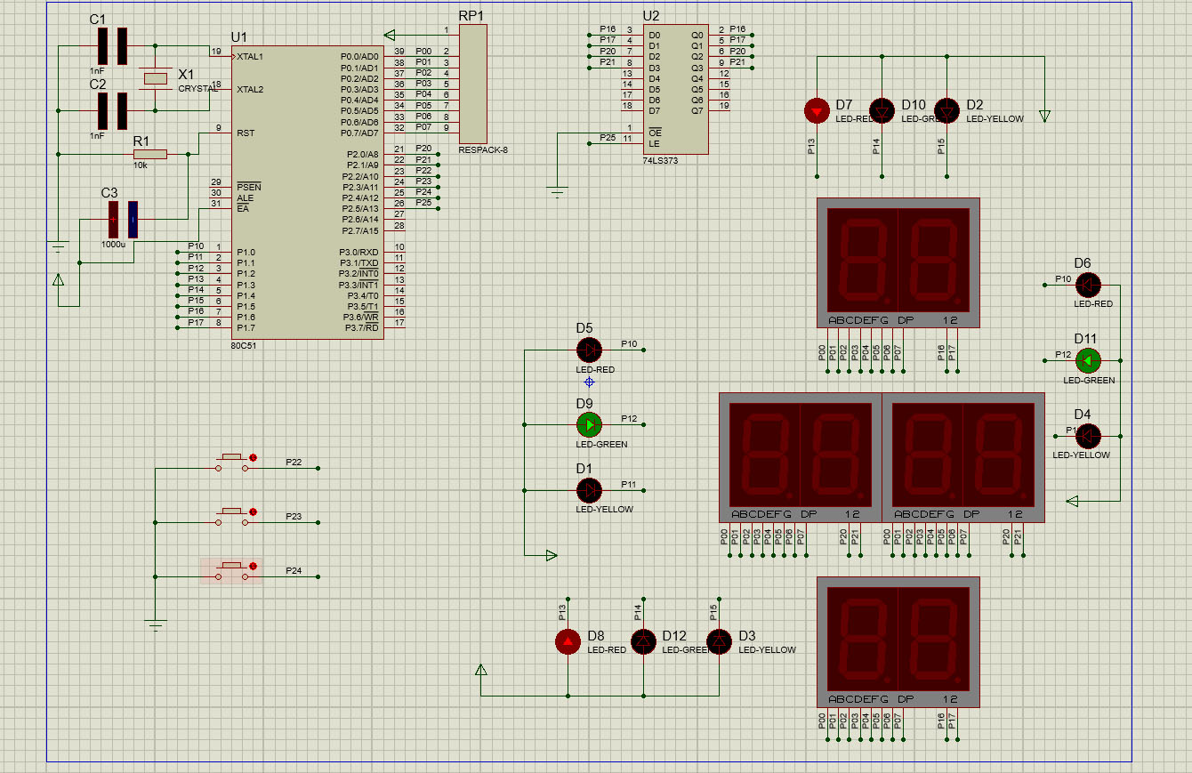

单片机交通灯 按键1切换长短时间,按键2增加时间,按键3夜间模式所有黄灯闪烁

uint LedBuf[10] = {
0xC0,0xF9,0xA4,0xB0,0x99,0x92,0x82,0xF8,0x80,0x90
};                            //0~9的数字显示共阳
uint Kflag = 1;                              //按键24的标志
uint LedNumNS = 27;                 //南北的数字显示
uint LedNumEW = 30;                 //东西的数字显示
uint i = 0;
uint j = 0;
uint j1 = 0;
uint k = 0;
uint g = 0;
uint z = 0;
int r=0;                                         //计数及状态的变量
uint LedTime1 = 30;
uint LedTime2 = 27;
uint LedTime3 = 30;
uint LedTime4 = 27;
uint Kf22 = 1;              //按键前一个状态的值
uint Kf23 = 1;
uint Kf24 = 1;
uint KSta24 = 1;              //按键的当前值
uint KSta23 = 1;
uint KSta22 = 1;
uchar Kflag22 = 0;              //按键22的switch函数参数
